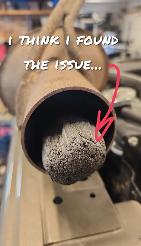

My '98's cat died a long time ago (only has one from the factory unlike newer models). While trying to figure out my loss of power, I discovered the exhaust clogged with cat honeycomb. I smashed it all out which gave me basically an empty shell, and drove it like that for 3-4 months until I got a new cat installed. Also just FYI I have a stroker motor. No CEL, no difference in power good or bad from normal, but it did noticably smell. I even had people comment at work that I smelled like gasoline or something a couple times because I was standing next to it idling before I came in. I think newer TJs with multiple cats are much more sensitive PCM-wise to having the cats removed.
