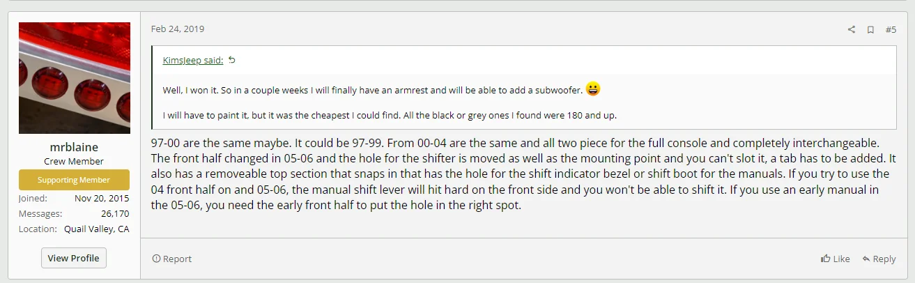

I read somewhere you described the differences between the older model TJ center consoles and the newer models. I have a 99 with the small console. I would like to put in a newer, full center console with four drink holders. Will it fit? Or, can you please send me the link to your earlier post that covers this as I can not find it. Thanks in advance and sorry to all for interrupting this thread.
Here you go -
