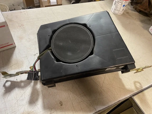

I have this:
https://www.crutchfield.com/product/item/default.aspx?i=206CWRT672
going in this:.. should I add poly fill inside the enclosure?

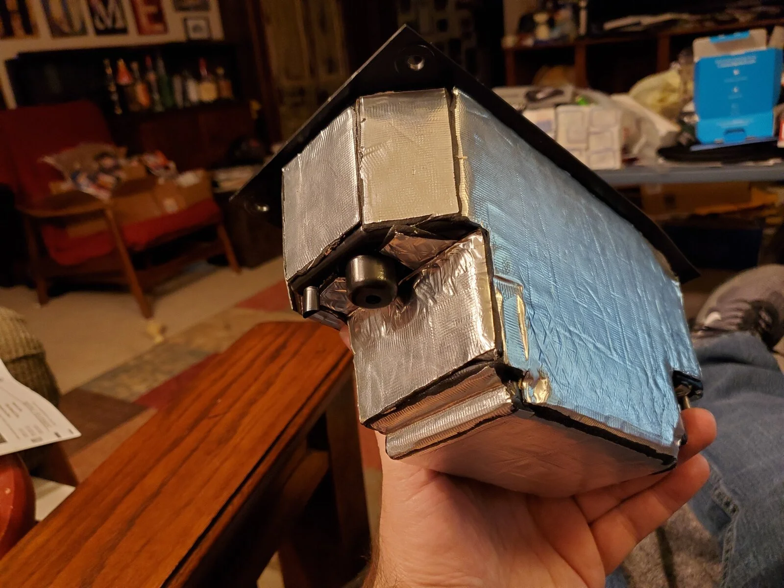

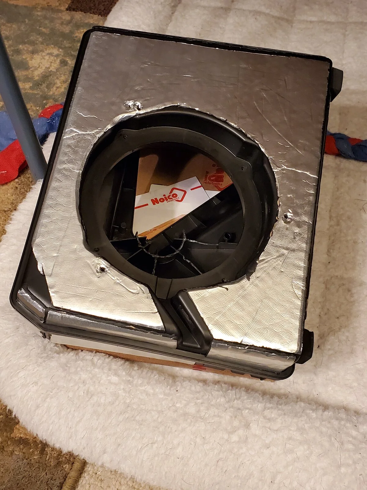

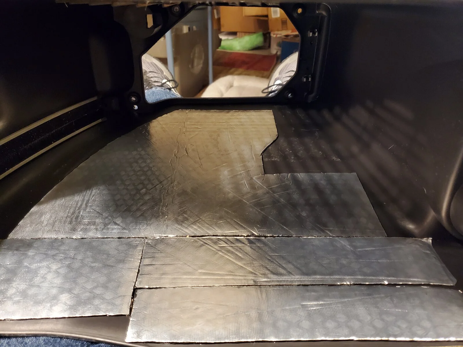

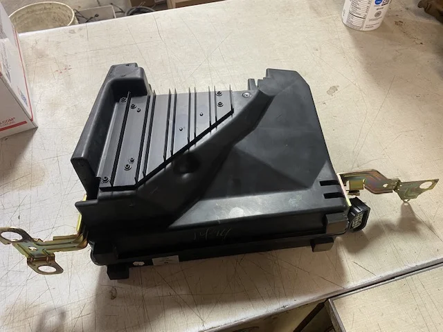

I have the same sub (but the 671 1 ohm version) in the same factory enclosure. I covered everything in Noico brand sound deadening. 10 sq ft for $20 off (cough) Amazon.
Every surface on the cassette tray. Already had it out, as I was putting a factory sub enclosure in where there was none before.
Every surface on the sub enclosure.

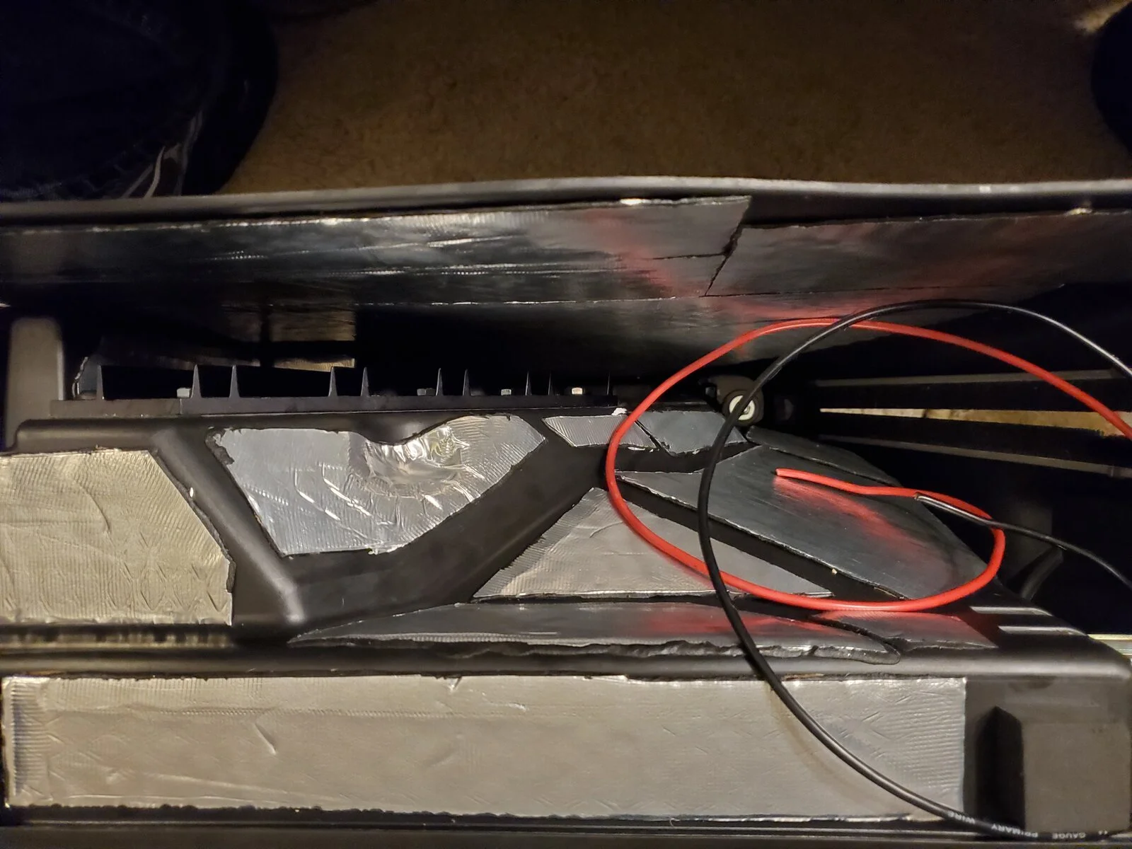

I trimmed the inside (only did one side in the console) to fit the sub enclosure. This side doesn't touch anything, except where the cutout is on the right side (see pic) where the enclosure contacts the console. The other side is screwed to the enclosure, and the enclosure had mat applied on every surface. It gets tight in there.
I pulled the factory amp and plugged the holes with locktighted nylon locknuts and machine screws. No polyfil, but a sealed enclosure. Kicker PXA200.1 amp. Got it all fired up today for the first time and I couldn't be happier! No rattles, deep bass, exactly what I was going for.
I have the same sub in the same factory enclosure. I covered everything in Noico brand sound deadening. 10 sq ft for $20 off (cough) Amazon.
