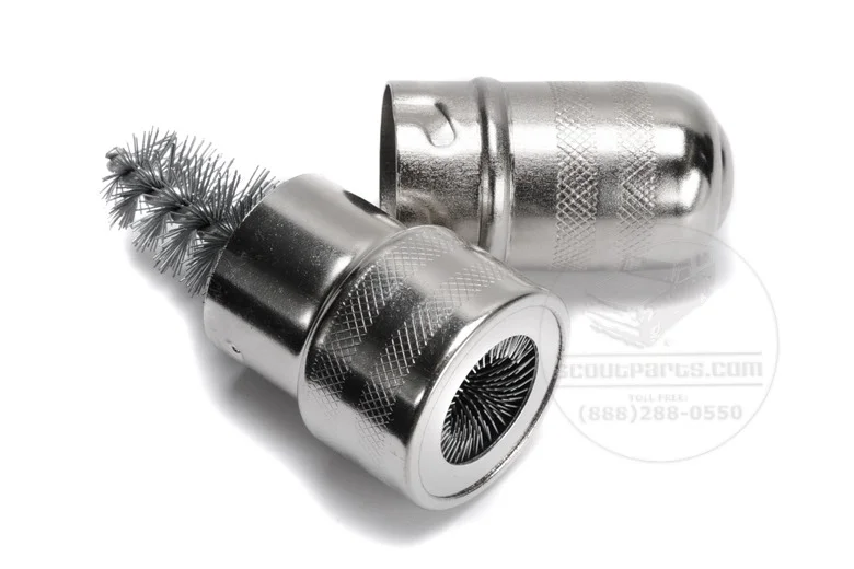

Also, starters clicking and not being able to start the engine are often not caused from a dead battery. That symptom is often regularly caused by bad connections between the battery post and battery connection. EVEN IF THE CONNECTIONS LOOK 100% GOOD. At least once a year I remove my battery connections and clean the posts and inside of the connectors with a wire battery brush as shown here. They only cost $3-5 at any auto parts store.
Lastly, as battery posts and connectors wear, you may not be able to tighten the connectors so they are on tightly enough. The bolt can't be tightened any more because the adjustment gap in the connector has closed up preventing it being tightened any more. You should not be able to move the connector on the battery post even with considerable hand pressure. If it can be moved, it's not tight enough.
The good news is that can be fixed in just a few minutes. With the clamp bolt removed from the battery connection, shave the lead from between the gap that the bolt squeezes closer together which will give it more adjustment so it can be clamped around the battery post tightly enough. I use a Dremel cutting wheel to shave a layer of lead out on both sides of the gap in my connectors.
