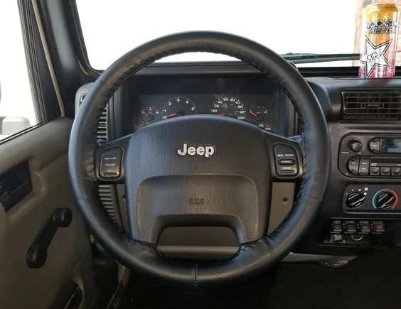

When my wheel went beyond hope, I bought a used wheel of off ebay that was in pretty decent condition. It was around $100. 2 years ago, I had a guy in TX wrap the wheel of my E28 (my daily driver) and it has held up extremely well. I can DM his contact info to you if you are interested.
@glowell222 can you DM me info for the guy in TX?
Hi TT-I just sent you a DM, though I can happily post his website here, as I didn't realize he had one! I reached out to him directly on the advice of an E28 forum member. The website is www.leatherwheels.com.
