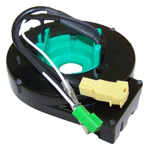

Here's a pic of the crown unit:

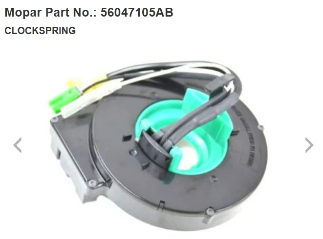

Here's a pic of MOPAR AB from mopar parts giant:
So, how do those compare to the one you have?
