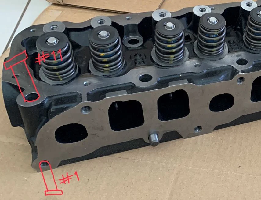

Hello,
I recently had my TJ head replaced and I've noted that I have a very very small leak through the manifold bolt #1, they probably didn't put sealant on head bolt #11 (the one that goes all the way down to the coolant)
My question is: does anyone know if I can remove bolt #11 without draining the coolant to put sealant on it?
leak seems to be 3 or 4 drops per drive, but my OCD wants to have it completely sealed :rolleyes: or should I just let it go? I don't want to cause a bigger issue for a few drops
Hole number 1 is not supposed to be a wet hole. Number 11 is definitely a wet hole.
You're supposed to use Loctite 592 which says to use on clean, dry threads.
