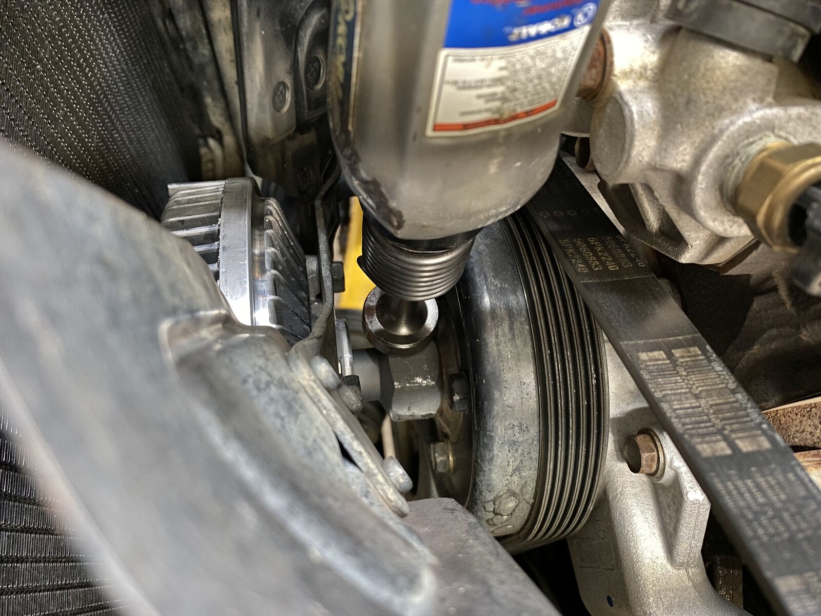

Do you have an air compressor? If so, you can use an air hammer it will pop it loose in a matter of seconds. Harbor Freight has them for pretty cheap if you have one nearby.
Put the air hammer on the edge of the nut and pull the trigger. It loosens it up enough to turn off by hand.
You could also remove the belt and use a belt wrench on the water pump pulley to hold it still while you turn the fan clutch nut. Pretty sure Harbor Freight has those too.

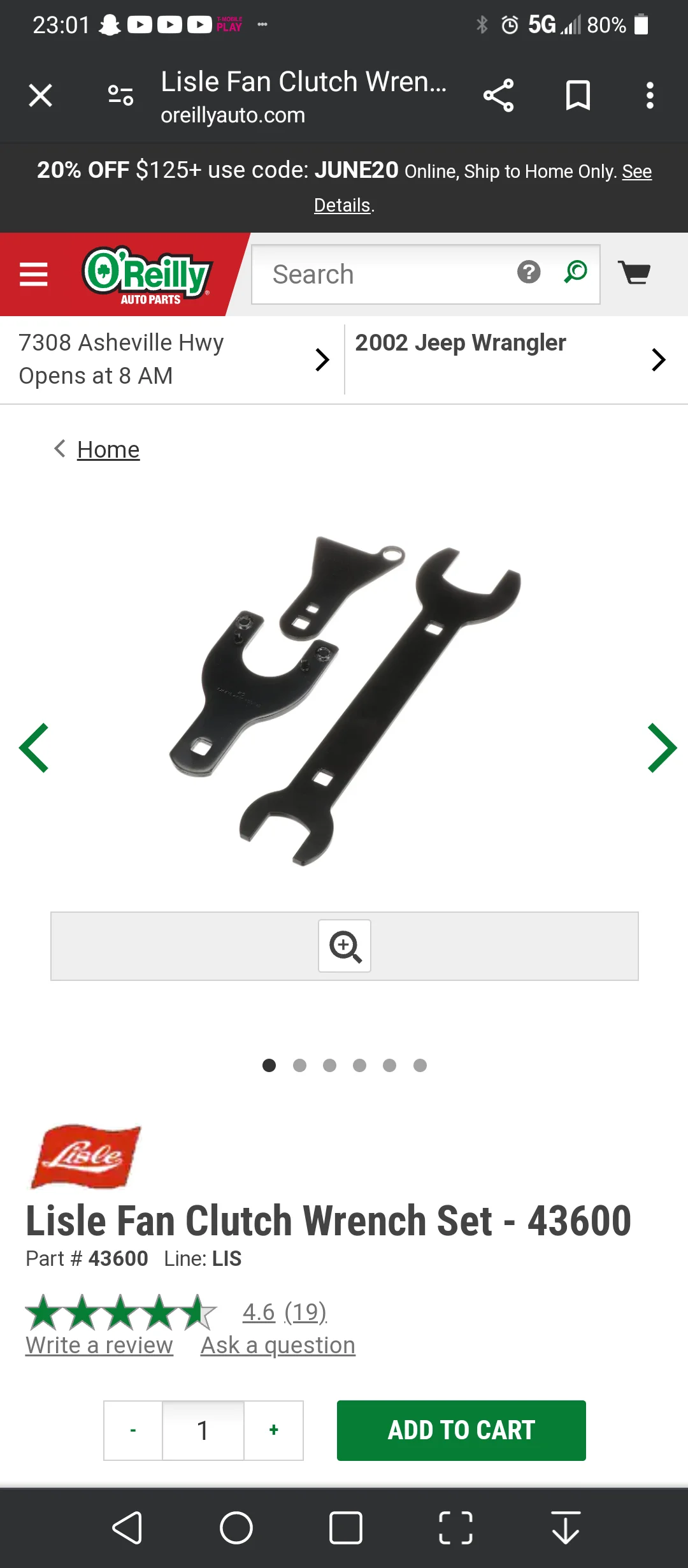

So... FINALLY got it fixed. It was the water pump, and once I got the right tool(s) to remove that nut, it went smoothly. That is, till I broke one of the spring hose clamps and had to ask a friend to run by Auto Zone and pick up an order I placed online.
I ended up getting this set from O'Reilly's
It was pretty expensive for likely a one off job. Amazon has the same set for less than $50. The 36mm wrench fit perfectly, but the pulley holder pins would NOT fit the bolt holes on the water pump/pulley (either side). Ended up using the triangle-looking piece, but the hole was too big for the water pump bolt. After putting a washer on it, the bolt was too short to start. Ended up using the bottom thermostat bolt to hold the triangle piece. Using a jack handle for leverage, the fan nut broke free easily enough.
