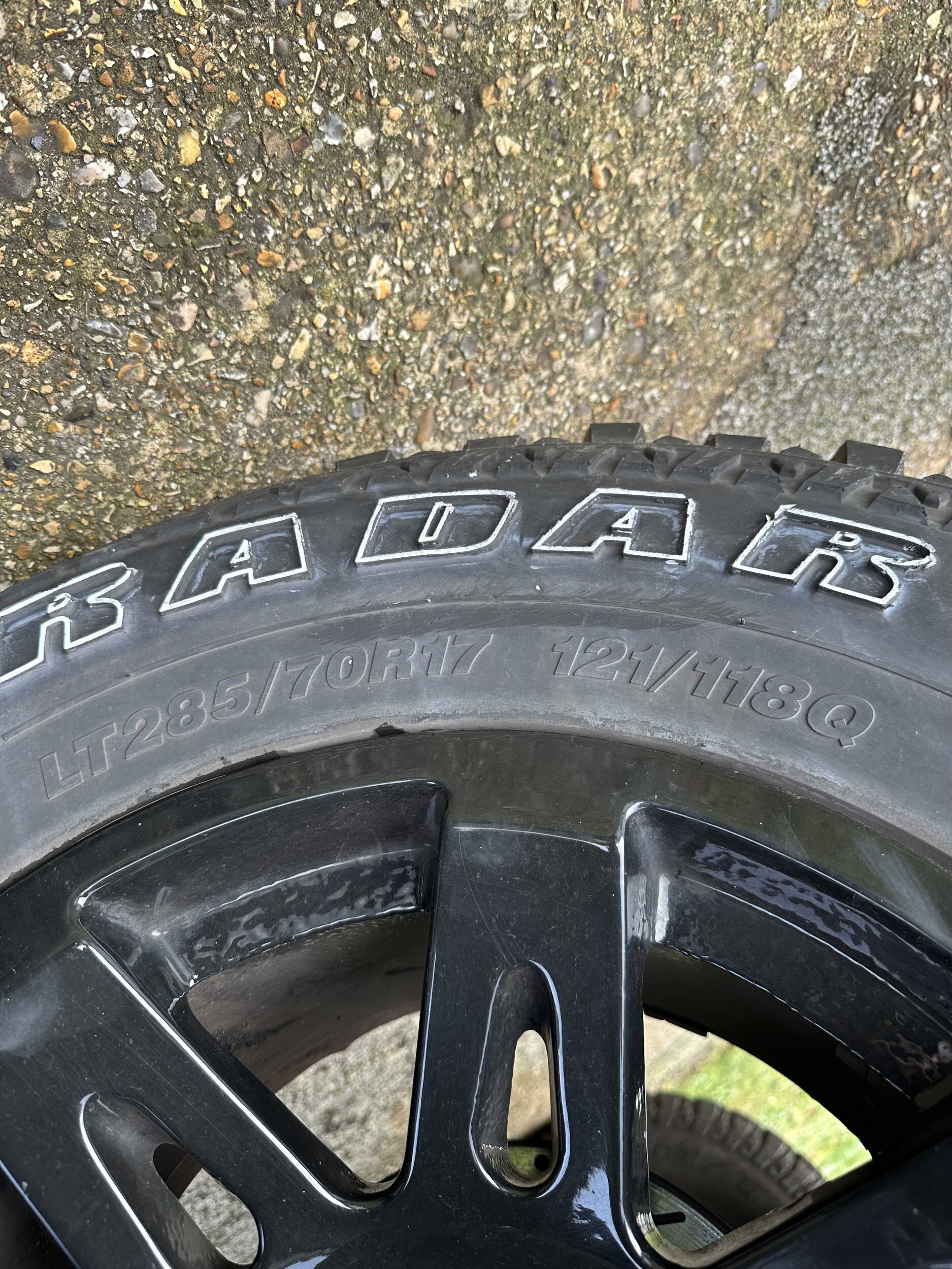

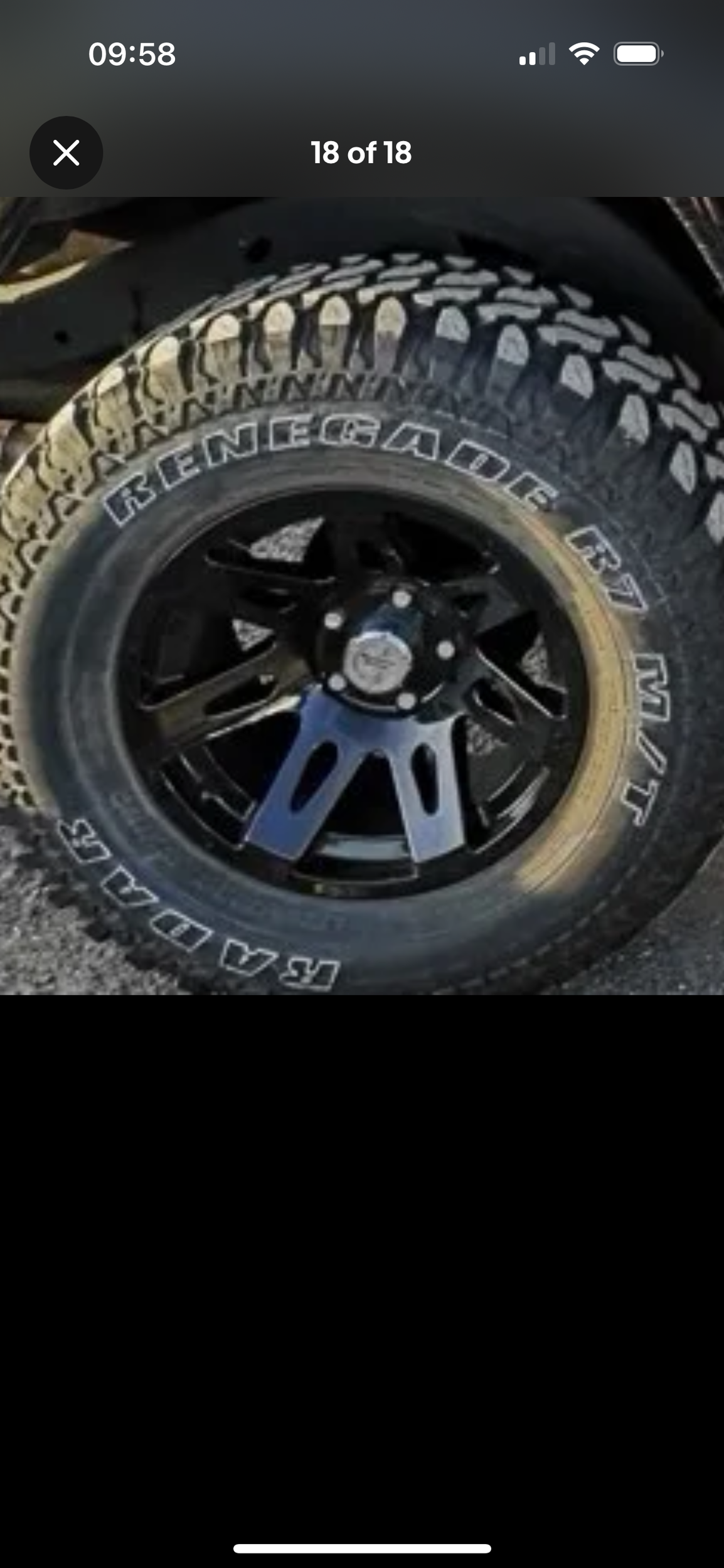

That’s a metric equivalent of a 32,7x11.2, so proper pressure is 26psi. If you are fully loaded with passengers and gear 28psi.
You may want to hook up with @UKTJ if you can. He’s a very knowledgeable member in your neck of the woods.
Very kind of you to say so, but probably a bit too kind as I am always on here looking for the benefit of the experience of yourself and others :)
Reactions: JMT
Yes the tyre says the load rating is E
yes sorry I meant around 30cm not inches 😂 just got the tape measure out and they are 10 inches.
Hi @Beardy, did you measure the tyre width or the wheel itself? I run a 285 / 75 / 16 tyre so very similar to yours at 32.8" x 11.2", but the wheel they are mounted on is 7" wide. For that size of tyre most manufacturers would recommend a wheel no wider than 9", maybe 9.5" for some at the absolute max - hence the recommendation not to deflate too much when offroad.

Very useful information so thank you mate. I’ve taken a note of those compressors. Just wanted something reliable that I could inflate/deflate my tyres when needed. I have inflated my tyres to 26psi and it now drives lovely on the road. They were sat at 16psi so no wonder it drove like a boat! 😂
