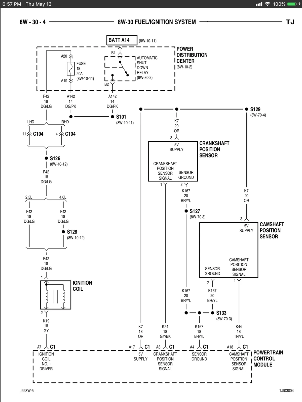

My 99 wrangler 4.0 manual will not start. After cutting out and shutting off in the middle of the highway after my clutch overheated in a traffic jam, I had to get it towed home. Turning the key only cranks the engine but I get no spark.
Fuel pump works, all the fuses are good, battery is good -this is definitely an electrical issue. I checked all the electrical connections I could find to make sure they were tight and after researching (a lot) I purchased an new PCM but it didn't solve my problem. I have tested the PCM (https://www.wranglerforum.com/threads/easy-way-to-test-your-pcm.418034/) at the important connectors (on the black plug- pin 2 (12volts), 17 (5 volts), 22 (12 volts), 31 and 32 are grounded ) so the PCM is good. I started replacing parts to try to fix it: New distributor (and Cam sensor), new coil, new crank sensor, TPS and oil sensor. I have tried the ASD (automatic shutdown relay) bypass and my coil gets constant power but no pulse. I also replaced spark plugs while I was at it.
What do I do now? I'm trying to pull apart the wiring harness looking for broken wires/ testing for continuity.

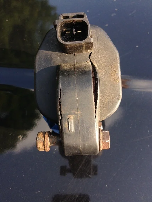

Take a close look at your coil for cracks.
I don't see any, and I have also replaced the coil with a new one
Augh, I see that now. Take a test light and back probe the gray wire at the coil plug while someone cranks the engine over. The light should flash on & off.
