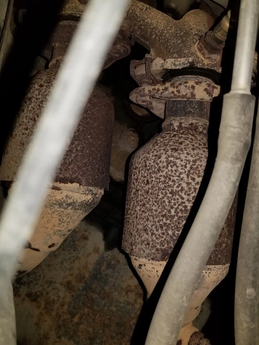

Ok, now im following a path here in my wiring diagram. Fuse with no power for injec is also on the same power grid for power for my o2 sens fuse that also has no power and same wire going to my ASD relay coming from the PCM. Would this have anything to do with my exhaust leak on the cat with the o2 sensors and engine light i had years for it?Checked ASD relay. Looks like i got my power to post 30 and power to post 86 and 85 with key on but no power to 87 with key on. I noticed injection fuse #28 has no power. Also checked power, grounds, and signails on cam sens and crank sens. Seems good there.
Ok this is what a i figured. Thought maybe the o2 sensor would not let the ASD relay power up everything seeing how to the o2 sensor goes threw the pcm. I am guessing o2 sensor dont even respond anyhow till after engine is running. So i was right on this one. 3 things start a engine. Fuel, Spark, and o2. LolExhaust leaks have nothing to do with anything electrical unless it's blowing hot exhaust on a wire or electrical component and melted it.

Ok so ran ran alot of other checks for cpu wiring and sensors. Guessing it may be a bad pcm. So i towed it over to a good shop i know. They came up with the same diagnostic after checking for 2weeks. Put in a new pcm, jeep started but ran rough like before when i first started with issue. My first isssue was run rough wont stay started. So mechanic fix my exhaust and replaced the cats. Jeep runs like new again. Now this post has closer. Thanks all who tried and help respond with some good suggestion on checks to do.Thanks for the advice Nick. Im running out of things to check here. My asd relay is shutting the power off for my ejecters. There are some checks im still working atm.
