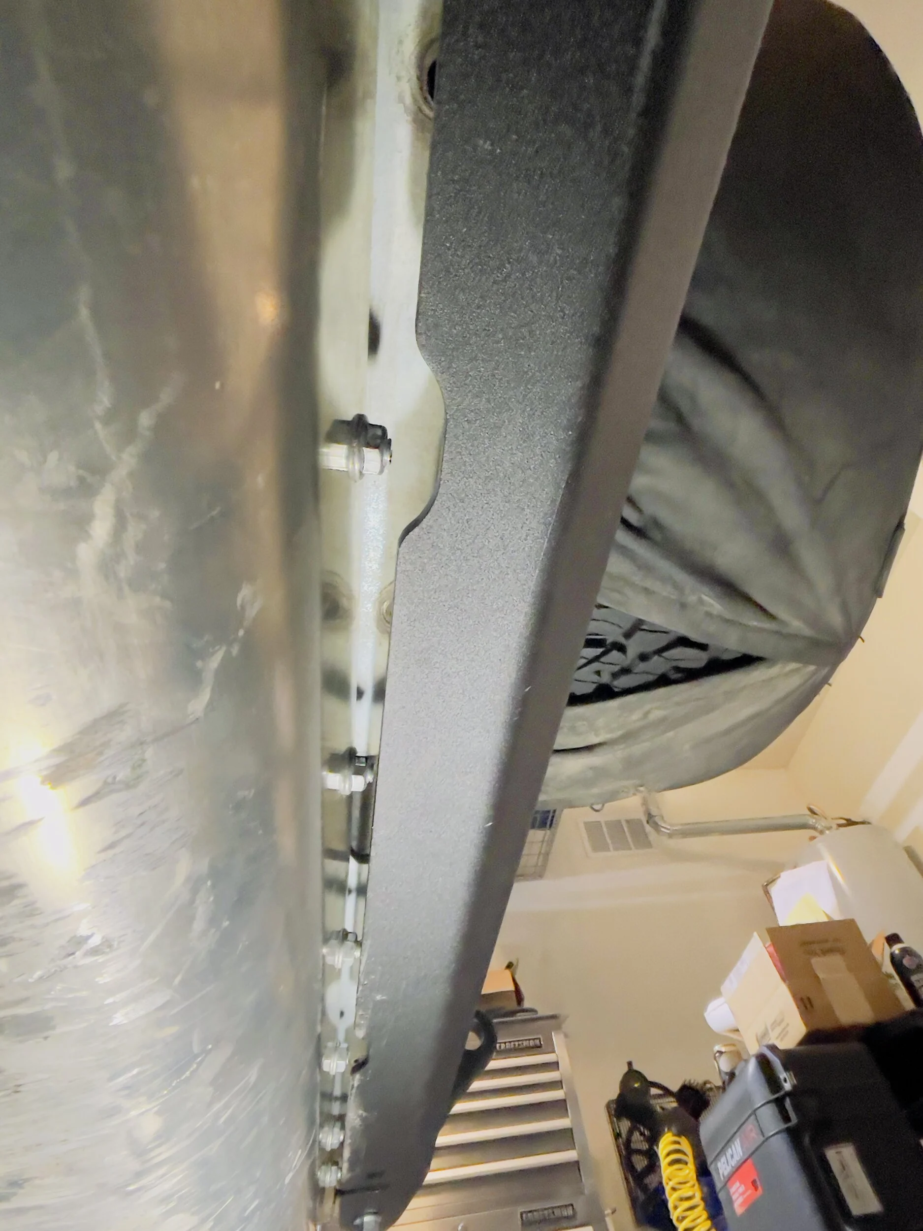

See below for installed but no access to the gas-tank skid bolts. You will see that it has two reliefs that give no access to any bolts.

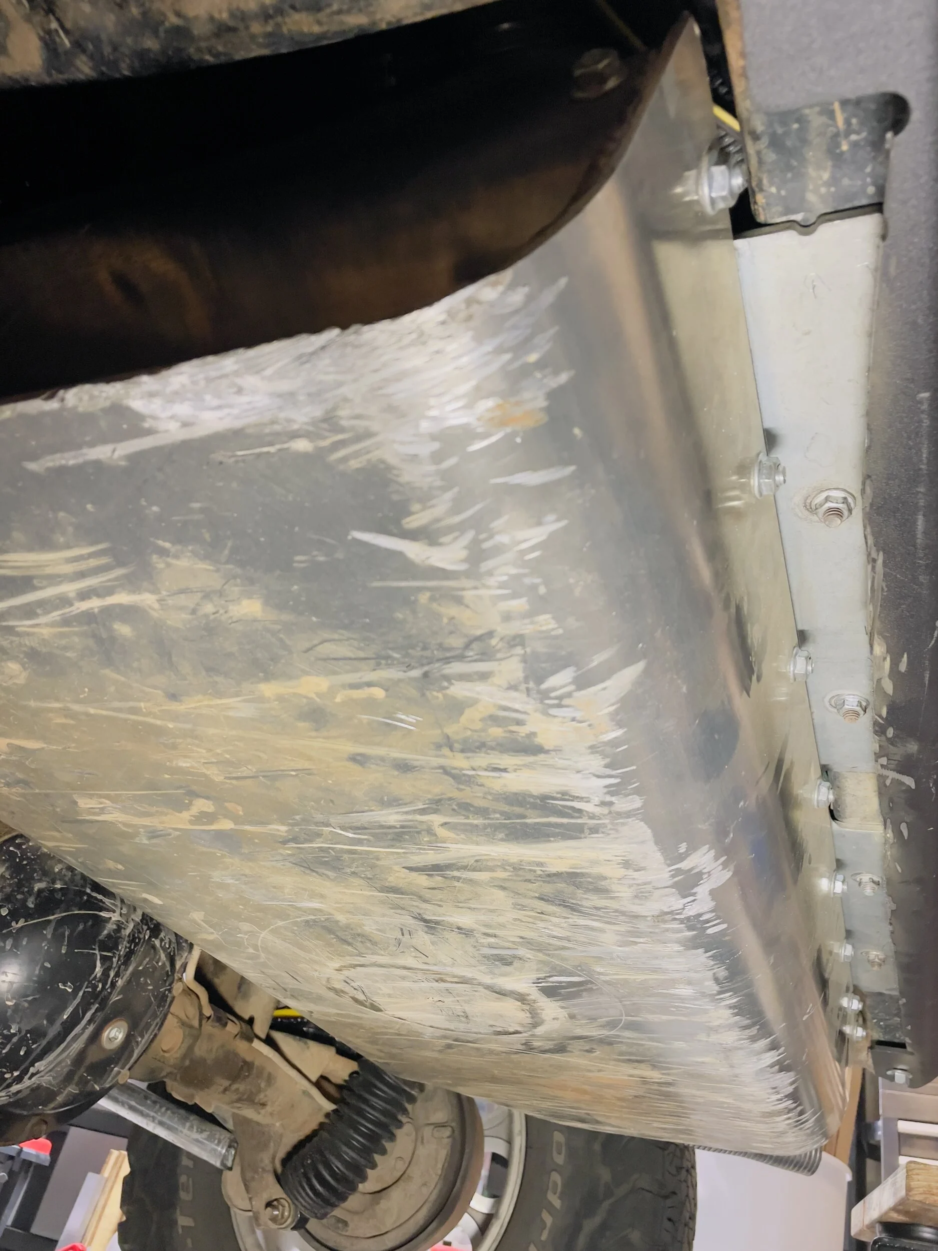

After a crude attempt to clearance the bolts.

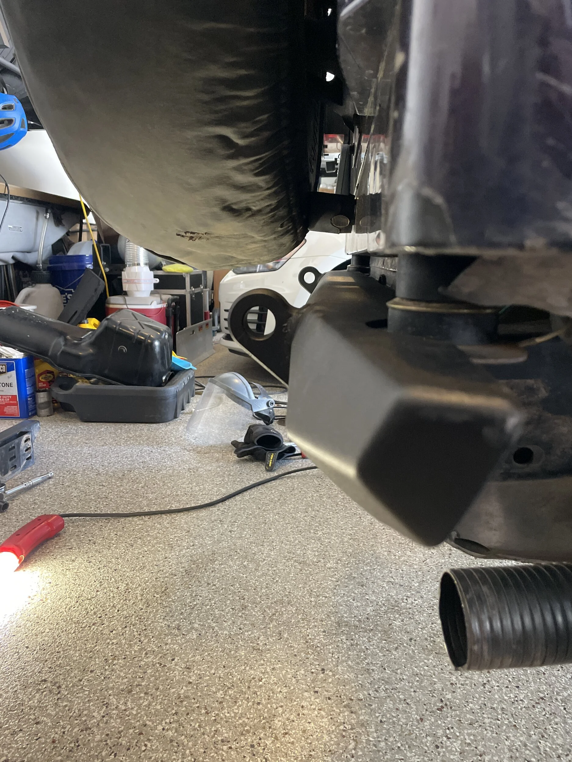

Lots of clearance for the 31 inch spare
