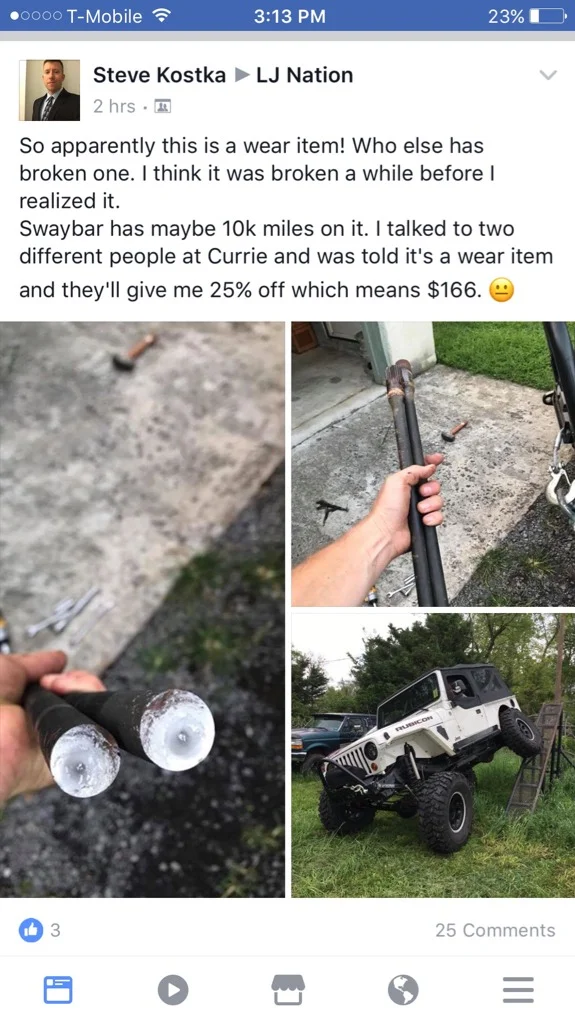

I just saw a post on Facebook of a bad experience with Currie support and within minutes 20 others commented their stories on how Currie basically said deal with it and they had to buy it again. Making me rethink getting their steering kit. View attachment 20573

jk? I thought that was an lj?? the problem isnt with the steering, it was with their anti rock which is the same for all models. Im just not wanting to deal with a company that will leave me up creek after spending hundreds more than any other brand. Im surprised to see all the comments on that post with bad stories of their customer service and failure to have any decent warranties.

In defense of Currie, if you go out and smash your new Currie RockJock axle, then call me up and tell me you broke a weld on it, why should I give you a new axle housing? You were after all, out beating up your vehicle off-road.
No amount of design (or metal strength) can make up for stupidity and all out bashing. How do we know he wasn't bashing the hell out of it and caused it to break?
Because I guarantee you that you could break ANY other torsion bar / sway bar disconnects on the market if you tried hard enough.
This is a tricky one... I would want to warranty my products, but how do you as the business owner make sure that your customers aren't taking advantage of you and destroying their Jeep, but then coming back to you and wanting you to give them a free replacement part each time?

The AR sway bar is designed to twist. I could see the bar eventually breaking from the constant twisting back and forth. Being that it's how it is designed to work, and the fact that is used in heavy duty off road situations, I can see them calling it a "wear part" and not replacing it under warranty.

That's a fracture right there, caused by improper design or a bad batch of heat treated parts.
Stress crack in the upper left quadrant (notice the minor corrosion?) and then a fatigue failure on the torsion bar. (Notice how the center of where it twisted off is off center on the bar?) My guess is that it was hardened, and then the temper was performed incorrectly. A Currie antirock torsion bar shouldn't break like that. It would be interesting to know the whole story, like how did that crack first get there? Those bars twist up just fine, but don't bend worth beans.
