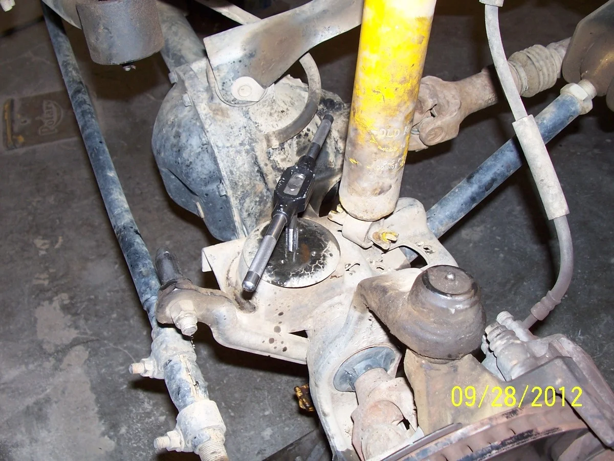

I wouldn't recommend gluing them in, but rather drill/tap threads in the spring pad and bolt them in.

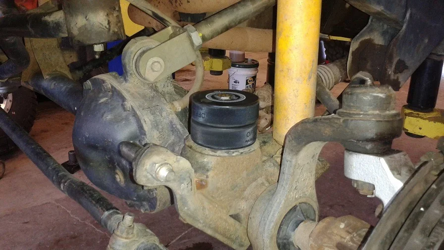

@ac_ , fill out your profile page brother. I don't remember what tire size you are running. That lift with 31's, you don't need any bumpstop extensions up front, and 1" extensions in the rear. Bigger the tire, the more extensions you need. I have ran 31's, then 32's, and now 33's on this same lift, with a few minor tweaks, but it all depends on the bumpstop extensions, and wheel back spacing, flare width, and tire width.

Depends. I am a bit over 2" lift and run 2" stop in frt and 2" in back, although I could get by with 1.75" in rear. Figured was more of a pita to cut them for 1/4". I have no issue clearing the tires, I needed the extension to prevent the shocks from bottoming out.
