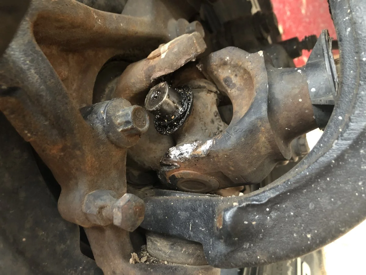

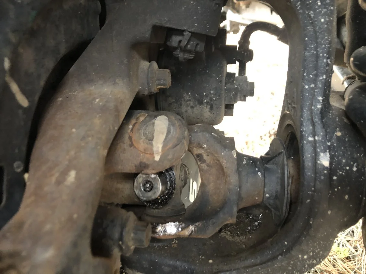

I have a lunchbox locker in my Dana 30 and 33’s. I broke a stock shaft a few months ago and upgraded to 4340’s. 32’s should be fine, but you never know 100%
Thanks, how long did the stock last and how did it break?
The stock lasted 2 years 3 months with that setup.
I gave it a little gas prior to hitting a steep embankment. It broke the outer ear on the passenger side.
Not the best pictures, but you get the point!
View attachment 154355View attachment 154356
