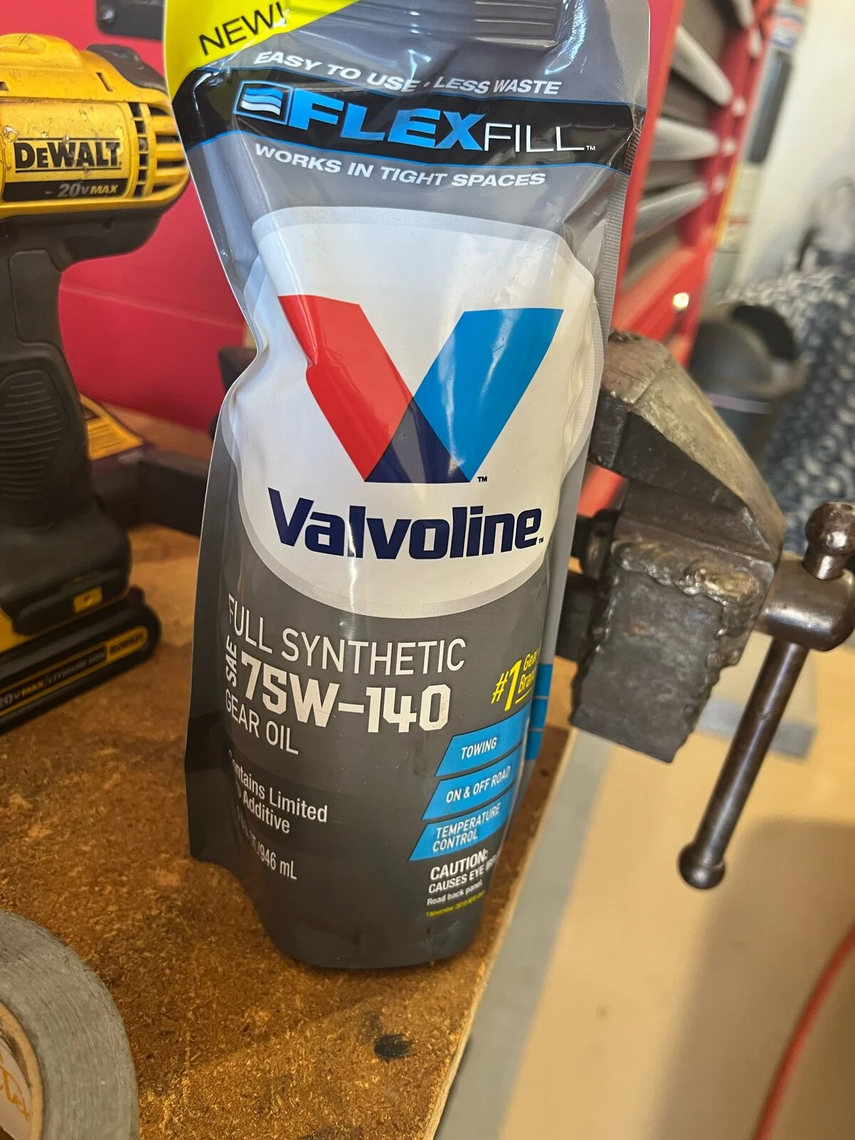

Did you do the little Spartan pre-check on the jacks? Sounded just like yours when I backed it out of the garage, so I put it back up on stands and did the Spartan pre-check thats in the manual, and it operated as specified. Backed it back out of the garage, took a test drive and I can't even hear it, works great off road too. This is the gear oil I used.
I’ll be trying this as soon as I get home. In your instance, it’s weird what manually turning it will do to get the oil to the spring cavities.
Since mine was previously assembled, when I took it apart and retained the springs, oil oozed out of those little retention holes. So I can’t imagine they are still dry.
I’ll report back shortly. Appreciate the input.
