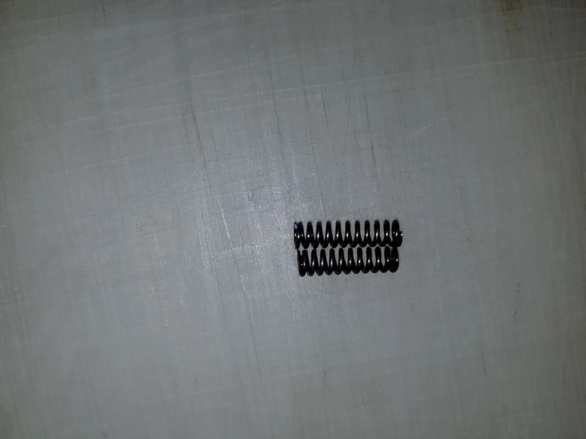

Ok sorry it took so long but the problem ended up being dirt in the springs (must have gotten in their when the outter seals failed) in the locker as well as the springs being worn down. All cleaned out now with new outterseals and springs.
If the springs were that bad in only 2yrs of use, how will new springs correct the issue? Won’t it just come back again later? I’m experiencing a very similar situation but only in 4wd. Changing to the correct diff fluid seemed to help quiet it down in 2wd, but still bangs in 4wd.
