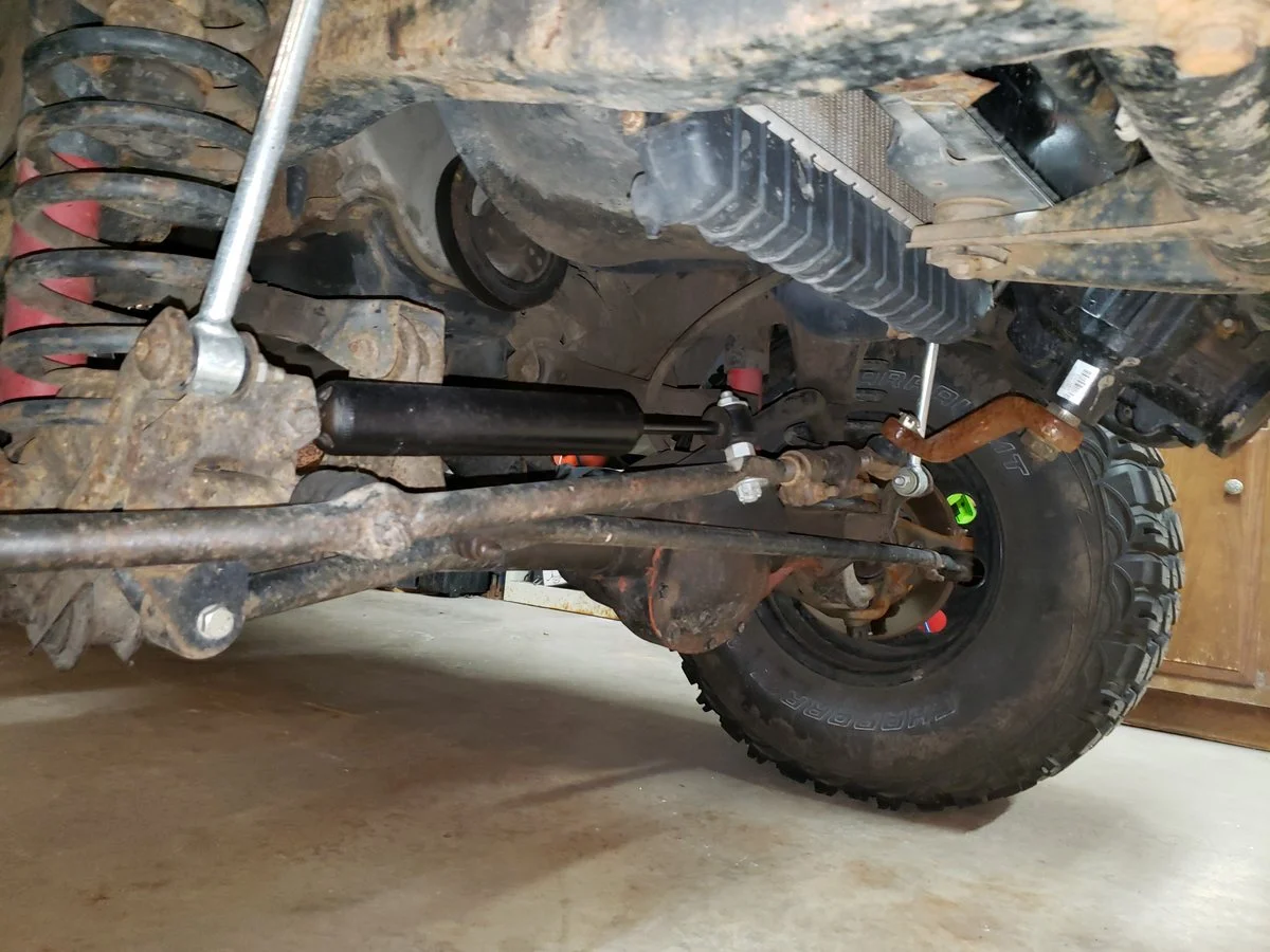

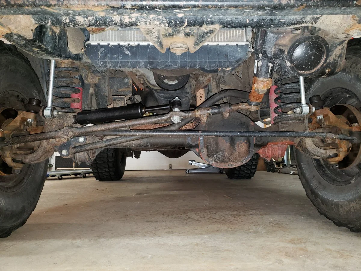

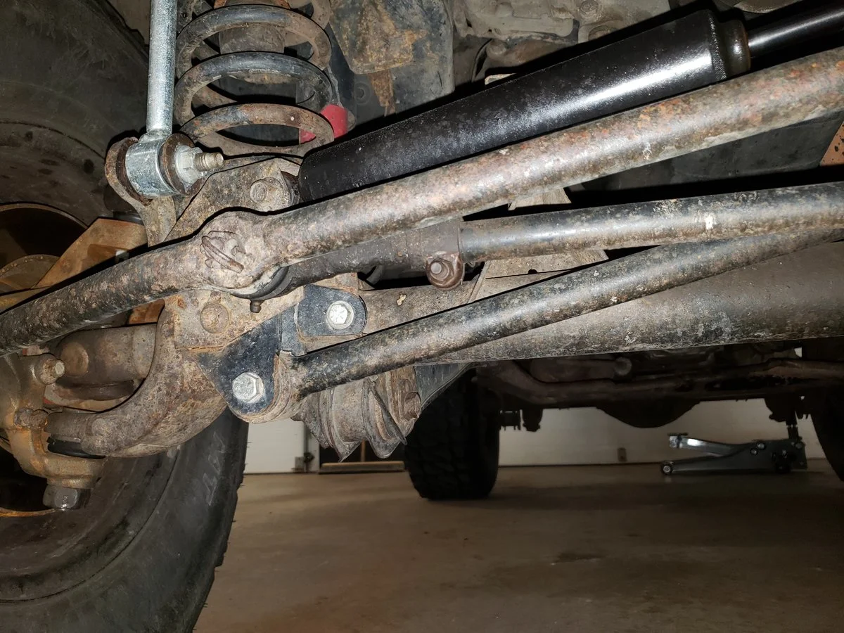

I got really bad death wobble last fall, just before putting the TJ away for the winter. It would happen on any small bump in the road. I crawled under the front end this week and started to figure out what the cause was.
The first thing I found was a broken passenger side track bar bracket. It's a relocation bracket to lower the mounting point. I was going to order a new one, but then started reading a bunch of posts on this forum. In the pictures I uploaded, you can see the broken bracket, but you can also see I have a drop pitman arm as well. It appears to me that I should go back to the stop track bar location, get rid of the drop pitman, and most of my issues with death wobble and bump steer should go away as well. Is my diagnosis correct? The TJ has a 3" lift, so will I need a adjustable track bar?
Why would the drop track bar and pitman been put on to start with?
