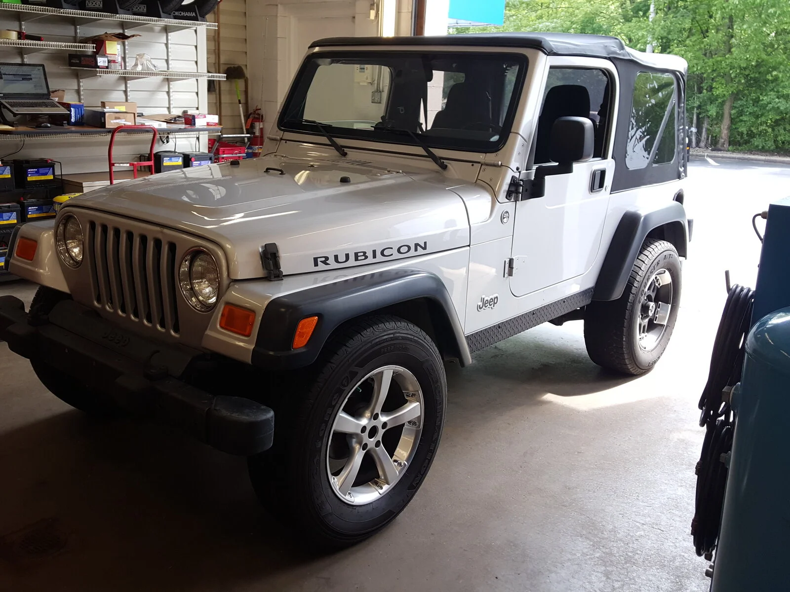

I have a 2005 Rubicon that I got about a year ago from a friend of mine.
3.5" lift with 32.8" tires.
RE springs with matching shocks
Supporting mods.
About 6 weeks ago it started getting death wobble every once in a while, and then more frequently until the Jeep was basically unable to be driven. It's not a daily driver.
I replaced the RE track bar with a Currie because of everything I read. I also replaced the RE stabilizer with a new one, bought quicker disconnects *(mainly cosmetic I'm embarrassed to say) and rotated my tires front to back.
The wobble didn't go away.
I bought the Currie correctlynk steering system, installed it, and did an at home alignment with some aluminum square bar.
The wobble is much better, but still there.
I think the bracket for the steering stabilizer has made contact with the track bar. I'll rotate it slightly up this evening.
The pitman arm is NOT a drop.
What do you think I should do next? I'm running out of ideas. Control arms are reasonably new.

DW doesn’t get better. You either have it or you don’t. It sounds like you have a shimmy. Did you get your tires perfect balanced? If you did, your tires are probably bad. They’re cupped, out of round, something. Have a friend with some wheels/tires you can switch over and try? I know you switched your fronts and rears with some positive results.
Also, some poor information in this thread. Don’t go spending a lot of money to fix things that aren’t wrong. Tires, tires, tires. I had to get a new set once to stop what began as DW, progressed toward a shimmy after parts, and was cured by new tires.

What do you mean, “the wobble is much better?” Do you have to come to a complete stop for it to stop, or not? Is it set off only by hitting an object in the road? Or does it begin at a certain speed? Or on a curve? Have you tried to toe out slightly? If so, Did this help?

On the off chance, and I know this is a long shot, but did you check your frame just behind the steering box and just forward of the track bar? If its cracked it will torque or twist causing some death wobble when you hit a big enough bump. Mine was and it caused me headaches for months before a tech found it.
I spent some time under the Jeep. The frame looks good and every bolt I put a socket on was tight. I did the preparation under the tire trick to see if the hub would move. It didn't.
I toed OUT 1/16" and the wobble seems to have gone away. I hit the bridge at the bottom of my road and it seemed like it was going to wobble but then it didn't.
I can definitely drive it now. I'm planning to take it to work tomorrow.

I'm not going to say anyone is right, or even wrong, about how to fix your DW.
I'll just post DW my experience: My TJ had real DW, not during what I'd call a good test drive with two drivers going 10+ miles on several different roads at multiple speeds, but about 10 miles into the 40+ mile ride home after buying it stopping was the only way to correct it.
First I installed a new Mood track bar because my son thought the original at 63,000 miles was too loose. Moog may have had slightly tighter bushings but it wasn't like it was welded to the axle and frame and it didn't stop DW. We tried rotating the tires and that didn't change anything so I took it to a great mechanic who I didn't realize had years of Dodge dealer experience. He did an alignment which corrected the 5/8" toe in:eek: but that didn't help DW. He said my tires stuck out too far and threw off the scrub radius.
I had to ask WFT are you talking about? He told me in the early 2000s all Dodge mechanics were taught about scrub radius by engineers that Chrysler sent everywhere to correct the earlier Dodge Ram 2500s that also had DW problems because their front tires were too far in, the opposite of mine. He had me try a couple different sets of used tires on some wheels with more back space than what mine had. Here is one of the front wheels installed for the test:
For about a week with those wheels I had NO DW. I found a set of 4 original Moab wheels to match my spare and got some new Duratrac 235/85 R16 and have had NO DW since I bought them in early June 2018. Mud packing up behind the spokes sometimes creates an unbalanced mess but not DW.
I do see you have wheel spacers and what looks like Moab TJ wheels. Maybe you could try removing the front spacers and going for a test drive and see what happens. Just keep in mind you don't want to turn too sharp in a parking lot. I get away with no spacers because my tires are basically 31.75 x 9.25
I drove it a lot today and hit a bunch of bumps that I thought should make it wobble. It was perfect, and perfect Jeep weather.
Maybe the 1/16" toe out was the solution. Maybe going from 29 to 26 psi, it could have been the ~ grand in Currie parts I put on it. It also could have been the exorcism... we may never know.
