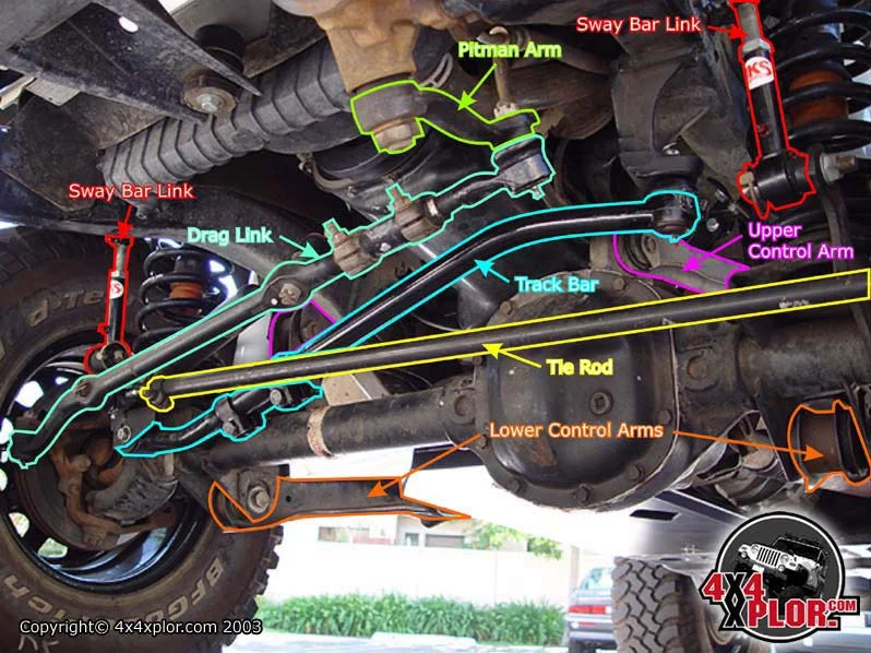

If this was a one time deal and there are no other symptomsI would say don't worry about it. However, get a helper to move that steering wheel back and forth while you put your hand on everything in the steering and front suspension. You will be able to feel stuff that is loose that you can't see nor can hear. Don't forget the check the ball joints!

No need to put it up on someone else's equipment to check for possible things that could have allowed that DW to happen. As suggested by Stinger, do that steering test. With the tires on one ground, have a helper repeatedly turn the steering wheel back & forth while you watch the steering components closely for signs of unwanted movement where there shouldn't be. Especially at the track bar where there should be exactly zero (!) side-to-side movement where it is bolted to the axle and frame when the steering wheel is moved back & forth. Nothing else should have any side-to-side slop/movement either. The tie rod and drag link will normally have rotational play since they are mounted on ball joints but that is it.
