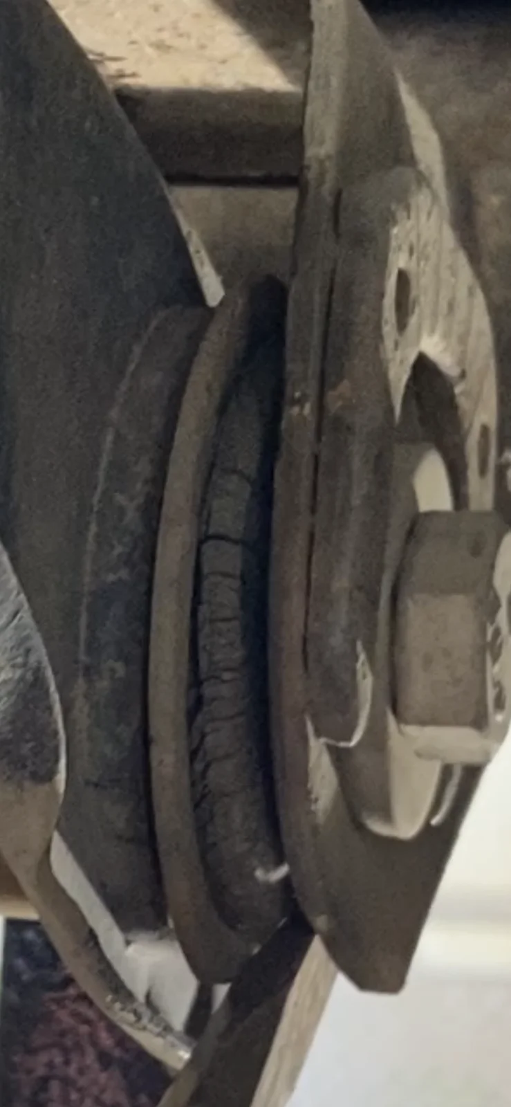

Well I’m pretty sure I’ve got cracks in the rubber. Here is a pic of the driver side LCA bushing at the axle. Is that past the threshold for replacement?
All the CA bushings look about like that…
Yes it is probably contributing to the problem and remember they can look perfect but be so soft that they won’t hold the axle in position -
Also if each one allows let’s say 3/16 of movement think about the cumulative amount of movement at every connection
I’m not trying to make you feel like you have to drive a whole new jeep up under it but at least things have some age on them and they have a lot of moving parts and the axles and steering are interconnected and there are a little over 40 bushings in the picture
