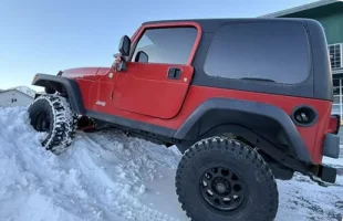

I just got my Woods DS and need to dial in pinion angle. I am currently within 3 degrees between DS and pinion with slight/minimal vibration. I have read numerous posts about the rear pinion as well as watched some youtube vids. I have dbj adjustable upper and lower control arms. From what I understand, I loosen bolt on lowers, but which side on uppers should I adjust, frame side or axle? Also, some vids I was watching was talking about tracbar needing adjustment too, is that something I need to look at? I do have a rear adj. TB. Sorry about another pinion thread, but just want to do things right and dial this in as clean as possible.
