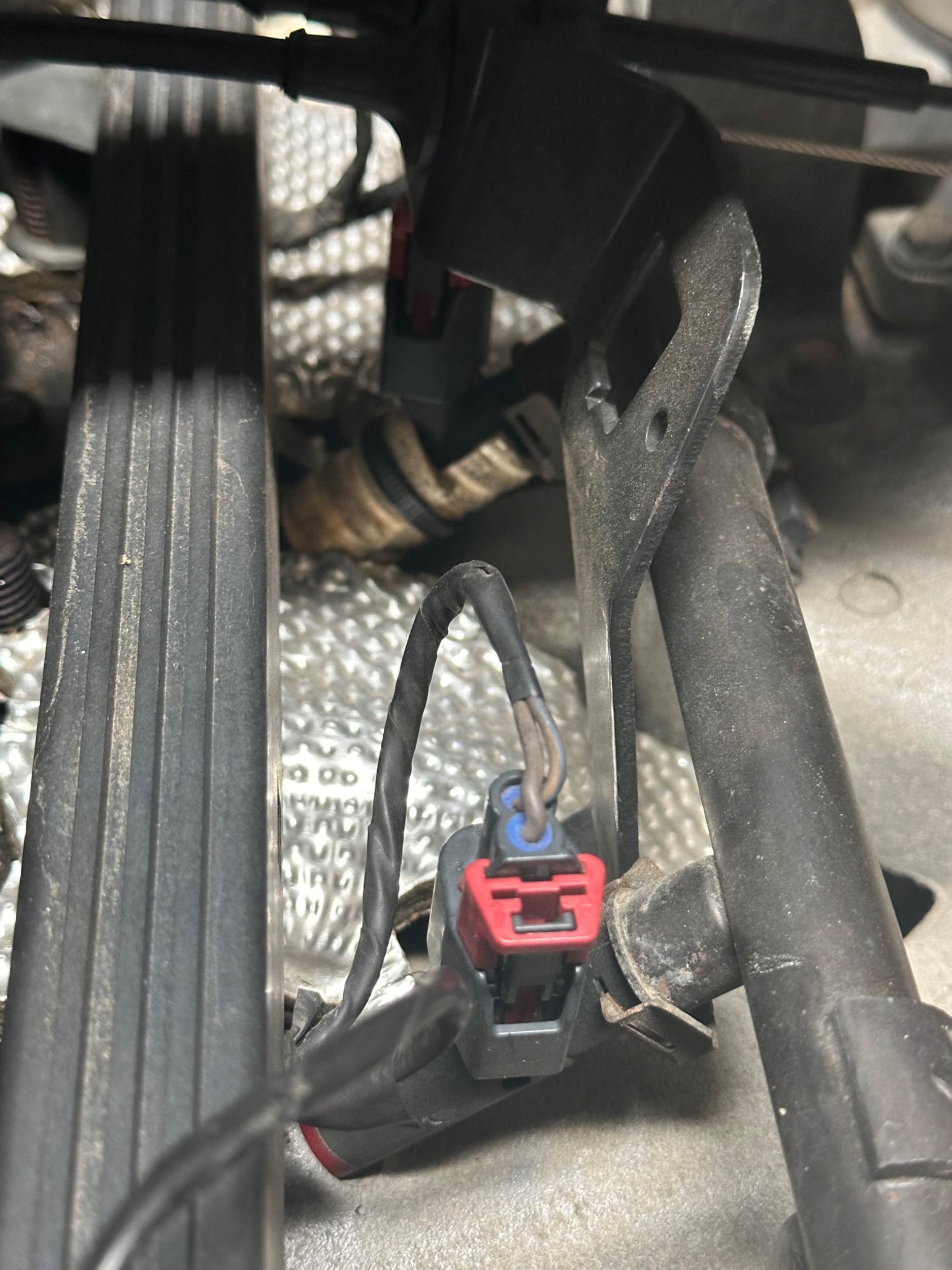

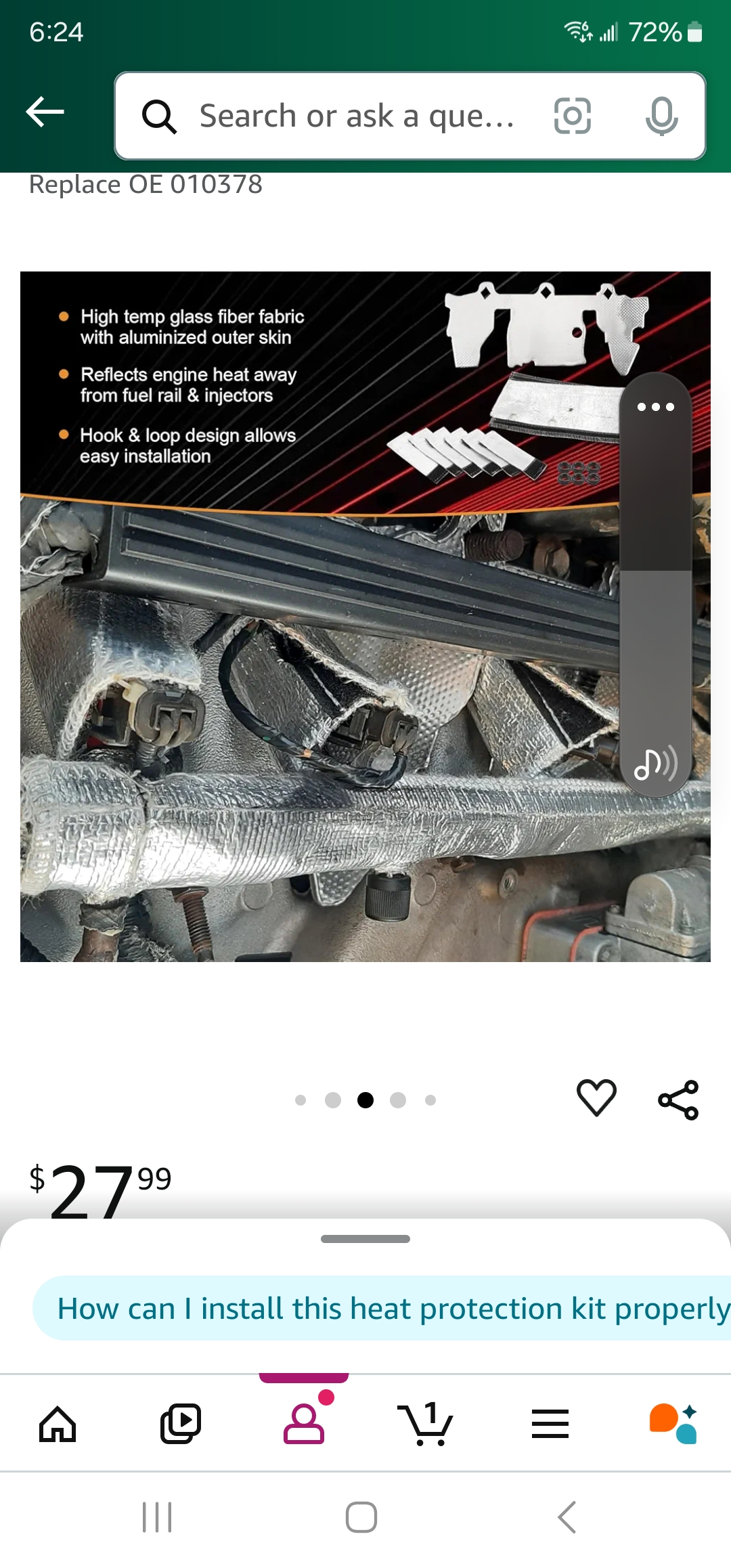

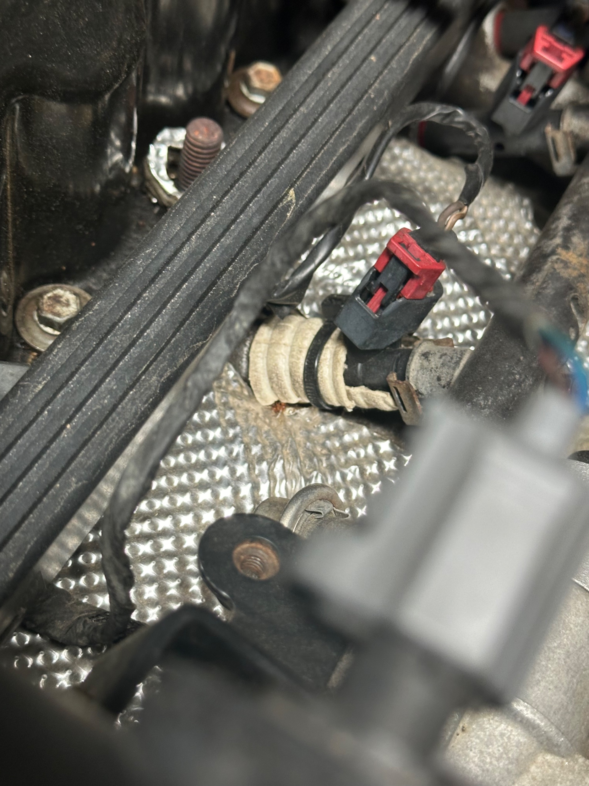

2004 tj unlimited was getting various misfires p300 was the most common. P303 04 and 06 would come and go as well. Replaced plugs all was good for a few months then started back - replaced crank positioning sensor again all cleared for a bit then got 300 304 and 306...they would clear on their own then come back. Usually would get them if driving in stop and go traffic or short stops at store gas station etc. Solution: heat shield was almost none existant and no heat wrap on fuel rail. I pulled fuel rail cleaned injectors and put new heat shield and fuel rail wrap on..30 bucks on amazon. All clear running smooth..easy to do took about 2 hours.

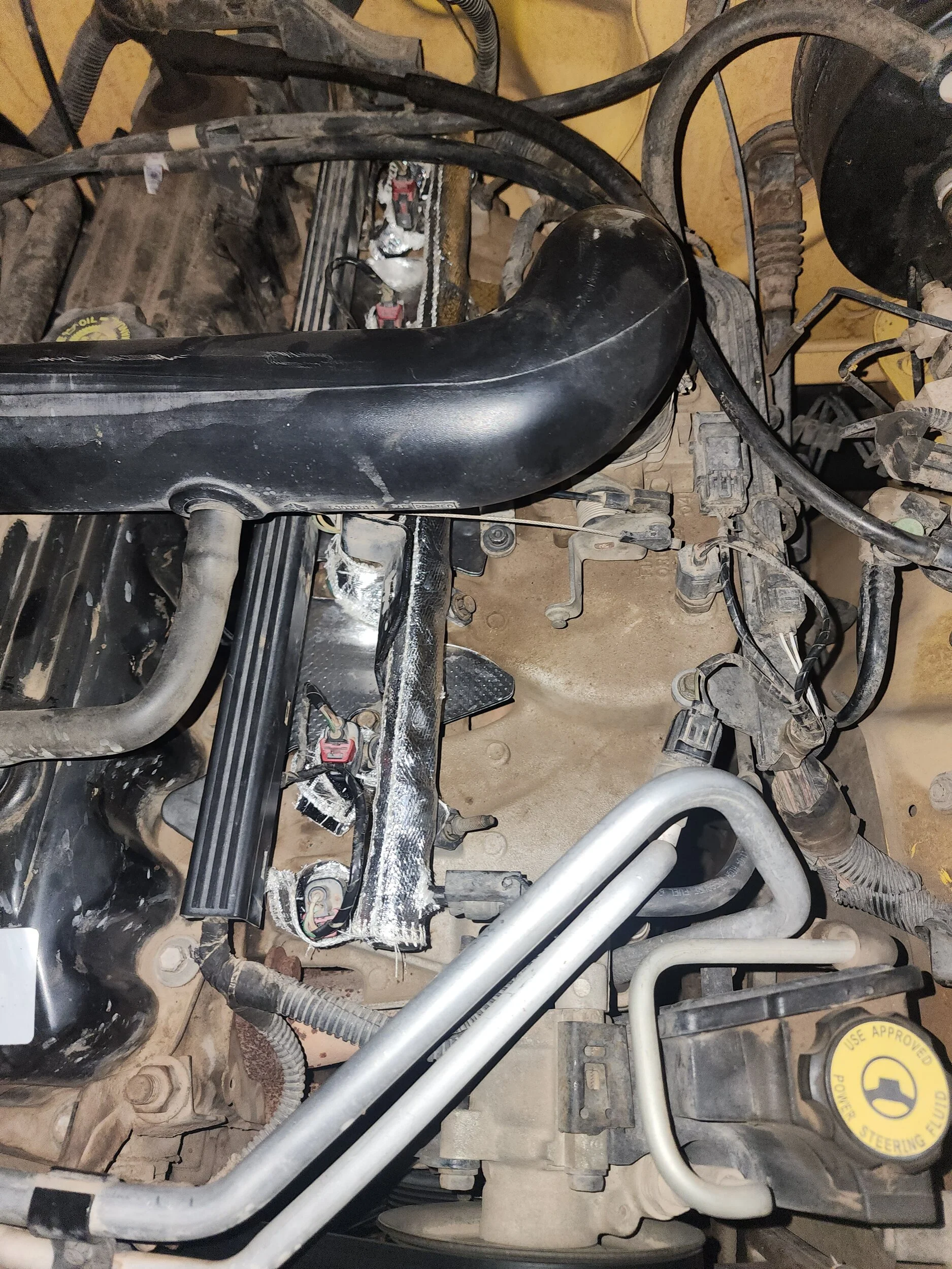

Fuel pressure: not just prime pressure and running pressure. Ideally, only test when it’s acting up and warmed up (seems to be a common theme). Throttle snaps and brake torque while observing fuel pressure.
Heat soak (wrap #3 & 4) injector at minimum and make sure your heat shield is in good condition. (See picks below)
Crank/cam position: possibly, tackle the top two first.
I'd argue that it depends on where you live. Texas hill country 110 days and an engine that runs at 210...fuel tends to vaporize in the rail and that messes with the injectors. For 28.00 and knowing you cleaned the injectors . Wrap it you're there anyway.
