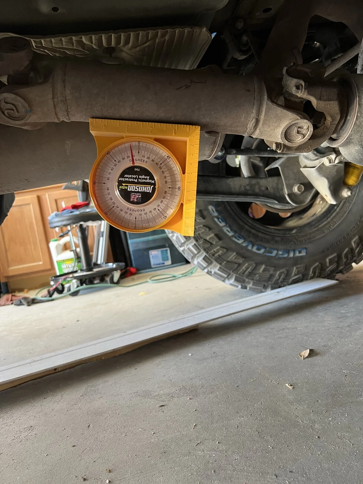

This is the angle after taking out the T-case drop kit
