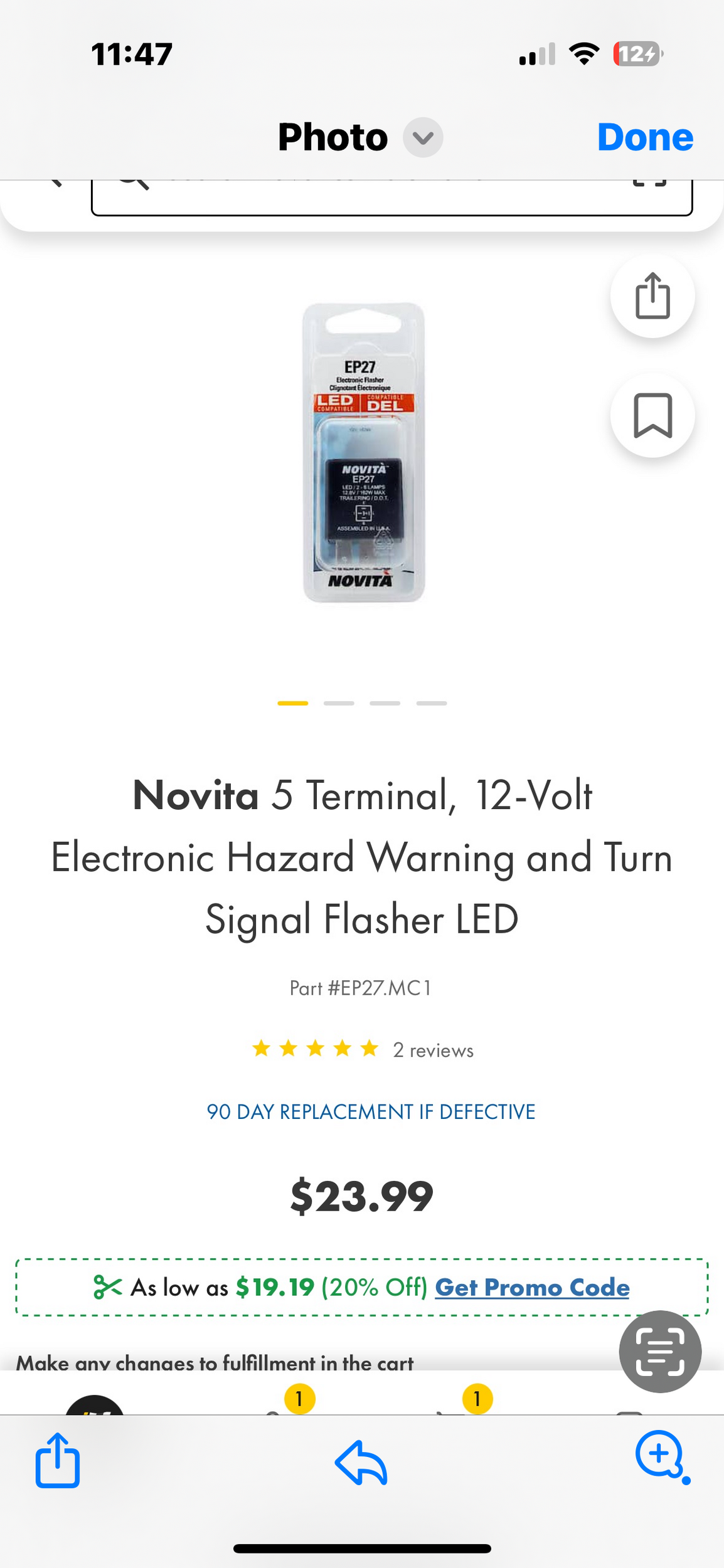

Here’s the LED flasher I bought. It’s an EP27 from advance

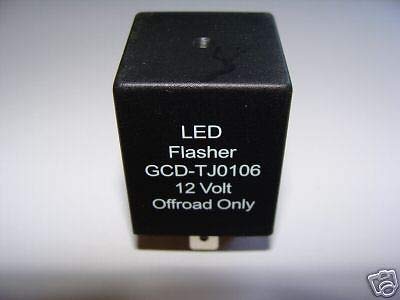

If you have a 2001-2006 TJ then LM470, E26, and E27 are all the wrong LED flashers.
You need this one:
https://www.amazon.com/dp/B07LC4DMS1?tag=wranglerorg-20
Works like a charm.
Rubiconned;
Thanks for the heads up on the Offroad flasher relay; which DID cure the Flasher Relay buzzing problem when the Emergency Flashers are ON.
I installed that relay since I exhausted ALL avenues of troubleshooting including the installation of (2) LM470 relays which did not cure my problem.
