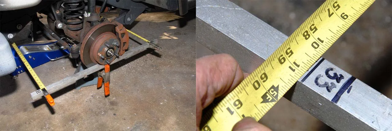

If you really want to get set up for future toe-in adjustments, go buy some 1" square aluminum tubing & spring clamps. Using them as shown below just makes it a little easier to make the measurements, plus the measurements between the sides are generally more repeatable too. Cut each aluminum square tube to maybe 5" longer than your tire's diameter and then permanently mark them at points equal to your tire diameter. Measure between them at those points.
