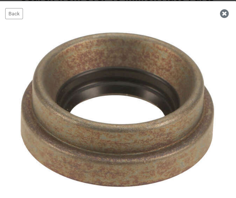

You should have asked. The inner axle seals have a stamped metal forcing cone that makes it almost impossible to damage the actual seal. If the axle shaft came out, they didn't take a hammer to the splines and create a sharp edge or roll it around in some sand and shove that into the seal lip, the chances of a damaged seal upon reinstall are next to zero.
What does happen 99% of the time is the diff is overfilled. Correct fill height is below the bottom seal lip when the shaft is removed. If it is above, then the oil in the diff runs out into the axle tube and eventually makes its way out the end and the owner reports "puddles" from a "bad" seal.
We do lots of brake kit installs. We do one side at a time, we raise the side we are working on higher than the other side because I don't like that phone call and I don't like trying to explain to owners that there is nothing wrong except a delayed appearance of all the extra oil they wanted to put in.
This is what the inner seals look like. There is practically no way to damage the seal since the forcing cone lines it up and shoots the shaft right through the middle of the seal. If you paid me to make one leak, it certainly wouldn't be my first thought to shove a just removed shaft through it.

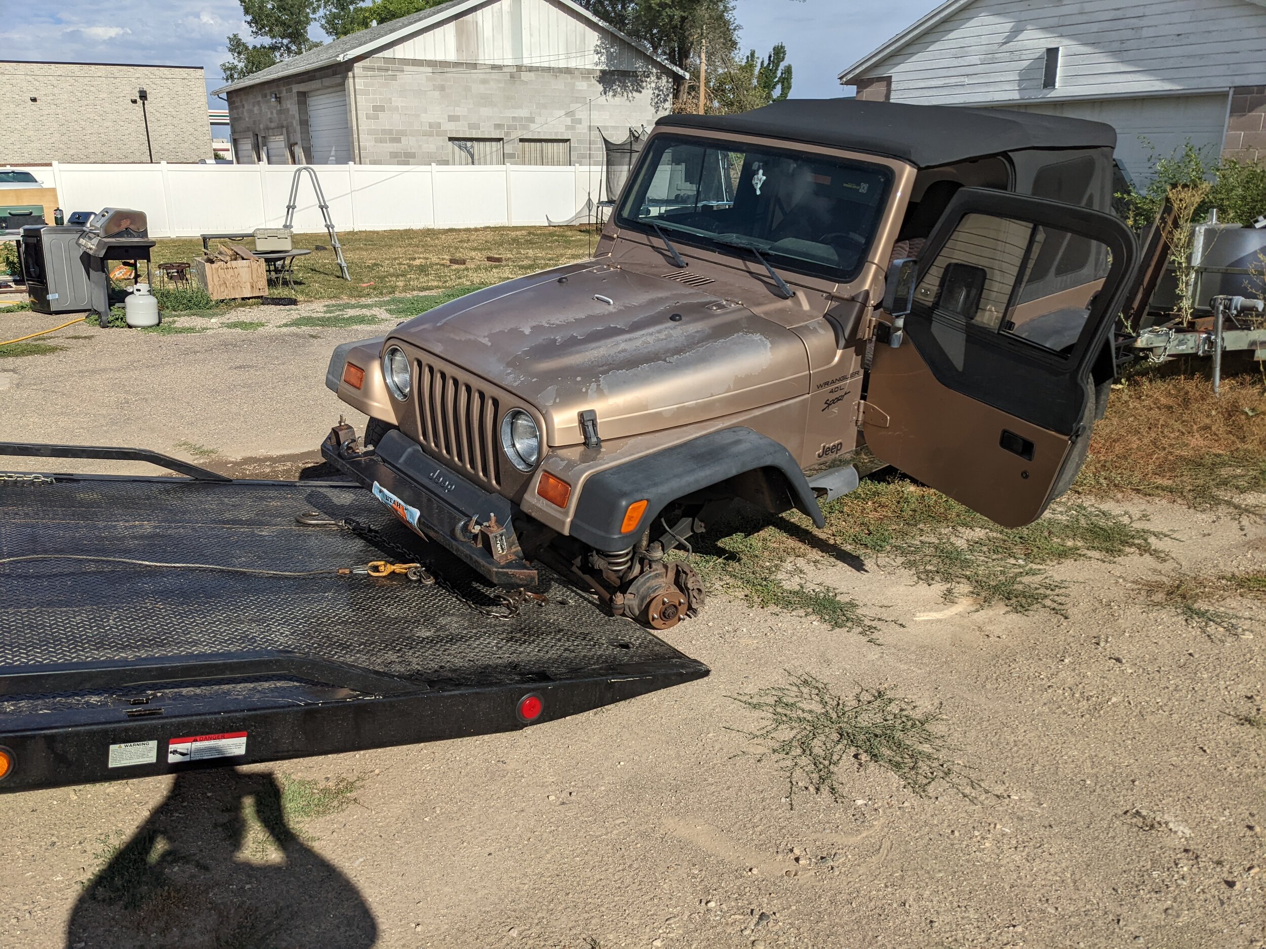

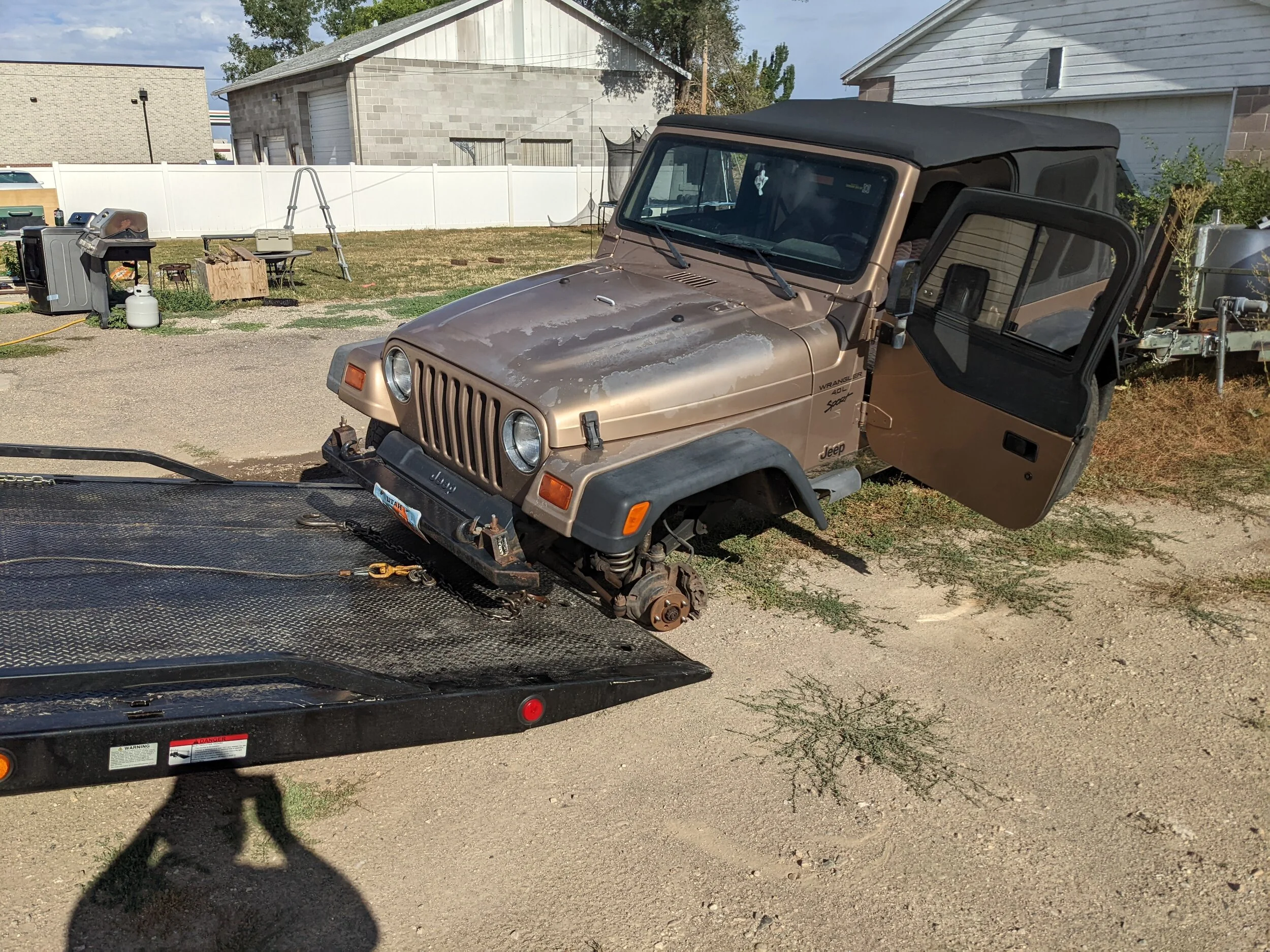

This is the same shop that caused this issue:
Basically, I went in for a tire rotation and a front axle shaft u-joint. I didn't have a press for the u-joint so I had them do it. Someone didn't get all the lugs tight and it drove great for about 70 miles before I got noise and vibration, then about 10 seconds after the noise started, the jeep converted to tricycle mode and the front tire rolled off into the sunset. No one was hurt, damage was pretty repairable. No sheet metal damage, just fender flares and everything attached to the knuckle.
Once this happened, I tried not be a dick and I worked with them to find some solutions we all were happy about. In the end, I saved them a chunk of change by not using the emergency tow truck UHP called to get it all the way back to their shop, I got another set of tires mounted and balanced for free to avoid a rental, and they happily replaced all 4 fender flares and the 2 mud skirts, plus all of the other damages. They won because I easily could have cost them a couple thousand more with no material benefit to either of us, and I won because I got the original issue fixed plus my fender flares replaced for free AND my samurai tires mounted and balanced for free.
I came out ahead overall minus some PTO, they came out about as good as they could hope for in the situation. Coming in hot probably would have had worse outcomes for both of us.
