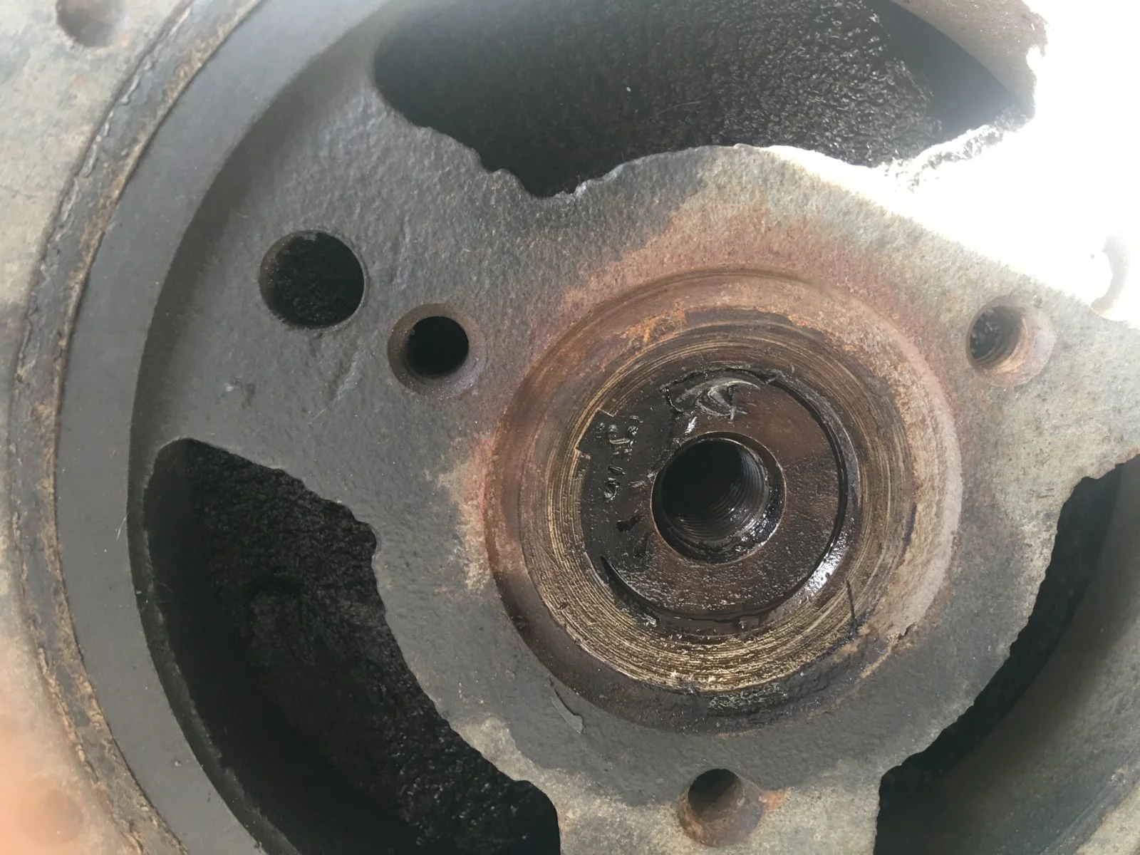

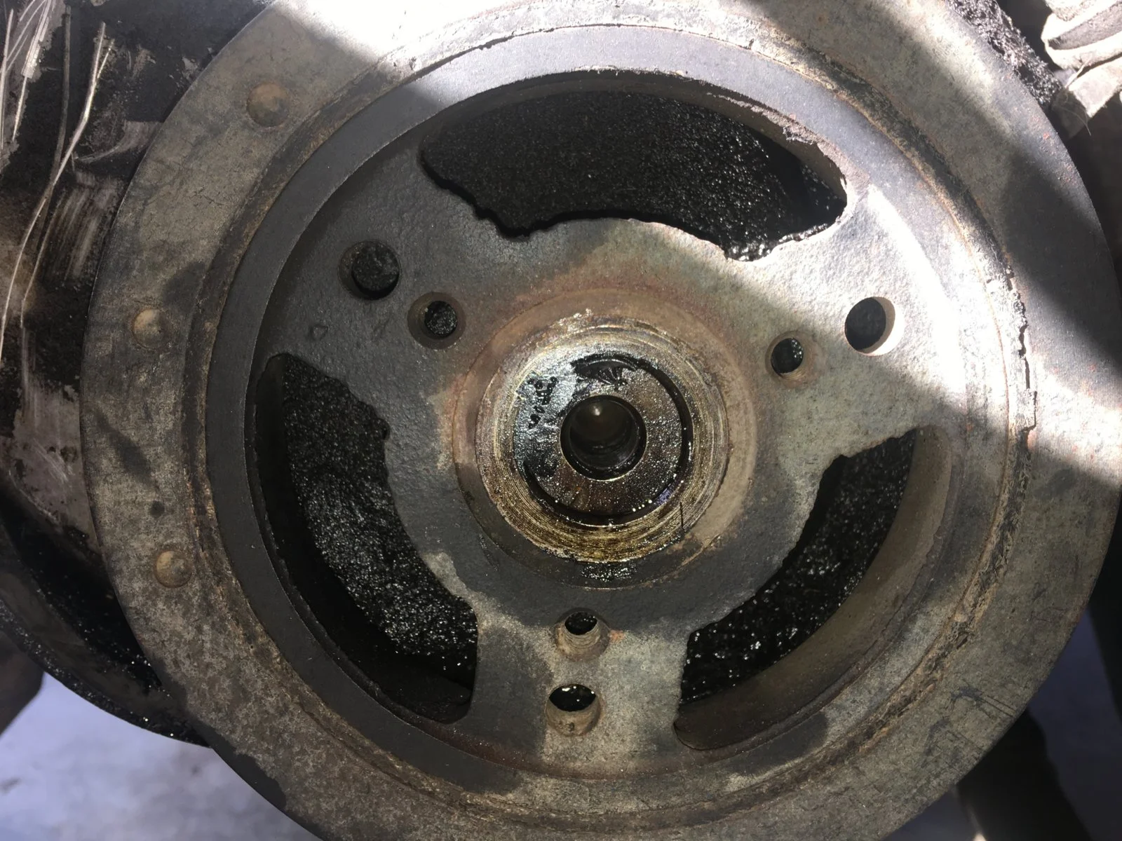

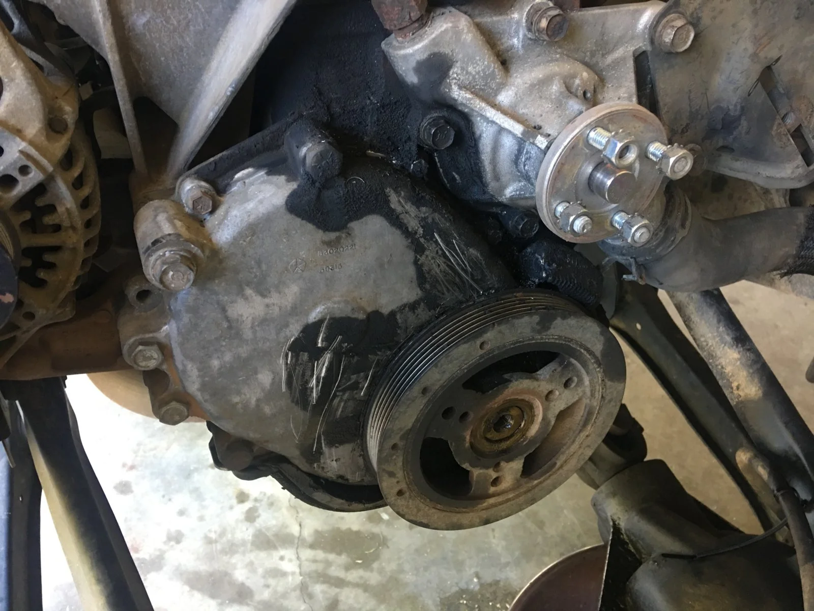

I am in the process of finding, and fixing worn out parts, leaks etc. I was in the middle of trying to find some horrible grinding noise coming from the front of my jeep. The noise magnifies when my wheel is tuned full driver side and going in out of drive way!? I then noticed a tick and leak coming from harmonic balancer. Do I attempt to do Timing chain Gaskets etc...
Any ideas on front end noise?

There should be a bolt holding the crank pulley on. I'm not sure how it hasn't come off yet.
I just assumed the OP had removed it but, if not, deff need to get that replaced!
From the pics, it looks like you most assuredly have a bad crankshaft seal. Until you get that replaced, check your oil level often. I also see some deterioration in the harmonic balancer's rubber. If it looks like it's giving up the ghost, a new balancer (while you're there) would also be in order.

EDIT: Also, if you would put in some info about your TJ on your profile (year, type (SE, X, Sport, etc.), engine size (yep, we see it's a 4.0 in the pics), etc., it can help the gang narrow down possible causes for issues.
