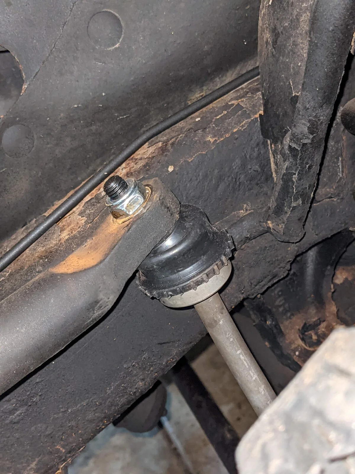

Does this sway bar end link look right?
f22beaver
Jul 6, 2021
116
Indianapolis
Pretty simple one here. New to me Jeep, death wobble at 55. Found a broken sway bar end link. So I replaced both sides and this is where I'm at now. Went back out on test drive last night and it was still there around 55-60 though it was less pronounced. So, before I go retorqueing everything else, does this look ok? I did torque top and bottom, I'm just trying to make sure it looks seated to all of you. To me it looks like it's tilted and I guess I would have thought it would have been straight up and down, i.e. perpendicular to the bolt hole.
Thanks!
Looks normal to me too. Torquing everything should happen regardless. It’s very possible the broken link wasn’t the cause and just a result of the death wobble
