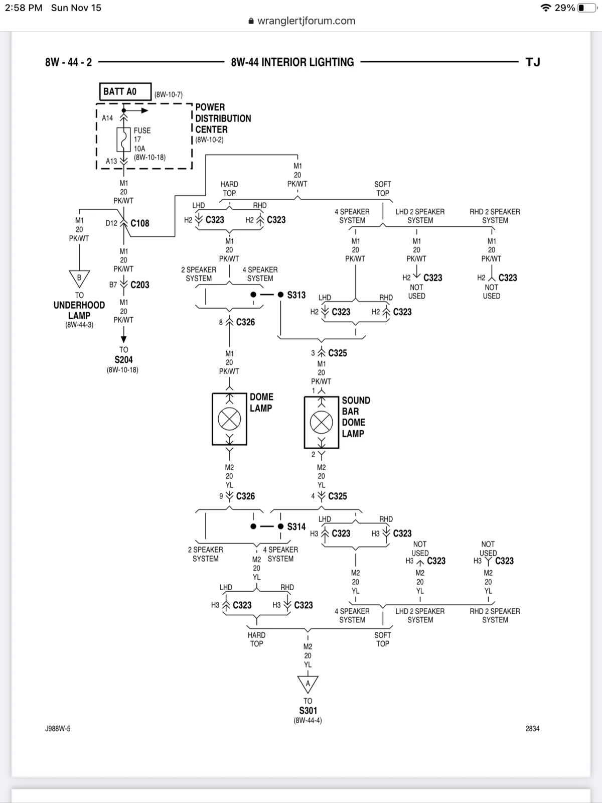

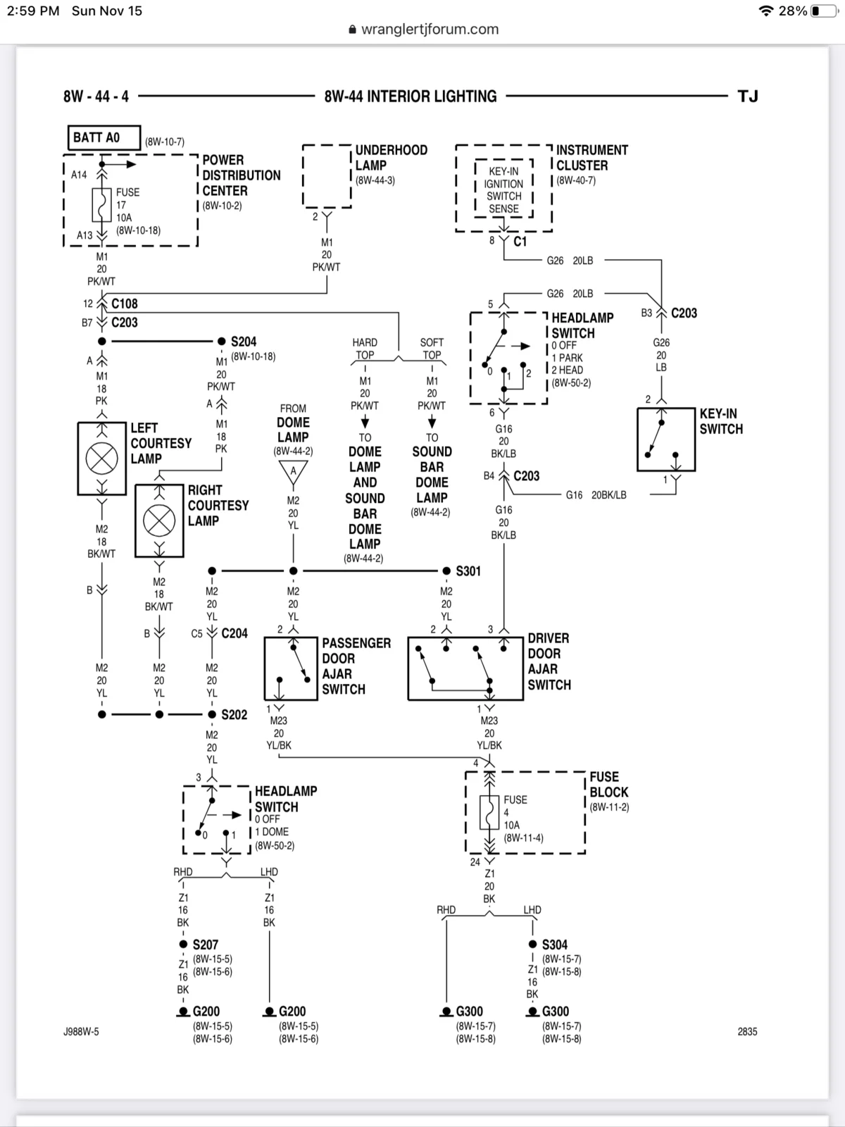

I can not get power to my dome light by opening the door or by rotating the light switch on my 1998 Jeep TJ. Number 17 fuse under the hood and number 4 fuse behind the glove box are good. I also do not have any power at the #4 fuse at any time. Any ideas?

Fuse # 17 in the PDC feeds all of it. #4 behind the glovebox is for the door jamb switch only. Do you have battery voltage at # 17?

Yes. I have voltage at 17 under the hood and nothing at 4 behind the glove compartment.
