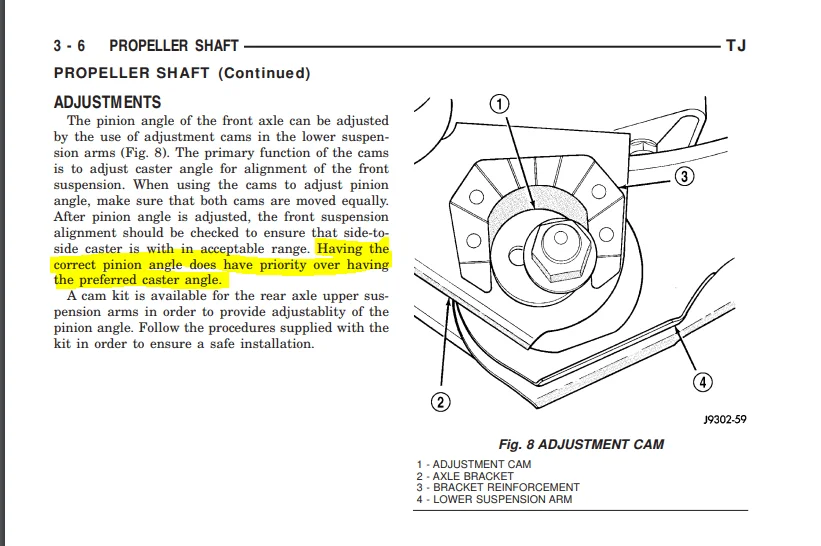

Ok hear me out for a second. I'm beginning to wonder if the angle is even what is causing this vibe.
I adjusted a little more up than previously then adjust a little lower than previously and it still does it.
