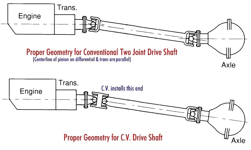

Here is a picture of proper driveshaft/pinion angle
Different jeeps react differently to changes in suspension height. First make sure your driveshaft is at a proper angle. If it is, and you're still getting vibes, installing a sye/cv setup will likely eliminate them. Only other option is to go with a smaller lift.
4" of lift is a tall lift, just a 1" tcase drop is seldom enough to get rid of the vibrations completely. You could temporarily drop the tcase further to get rid of the vibes. Don't screw with the rear pinion angle, it needs to stay at the factory angle until you install the SYE kit and CV driveshaft. At that time you'll need to raise the rear axle's pinion angle so it looks like the bottom drawing in the above illustration.
When properly installed and the rear axle's pinion angle is set as shown above, the SYE kit and CV driveshaft will completely eliminate all vibrations. You will be able to completely remove the tcase drop at that time.
