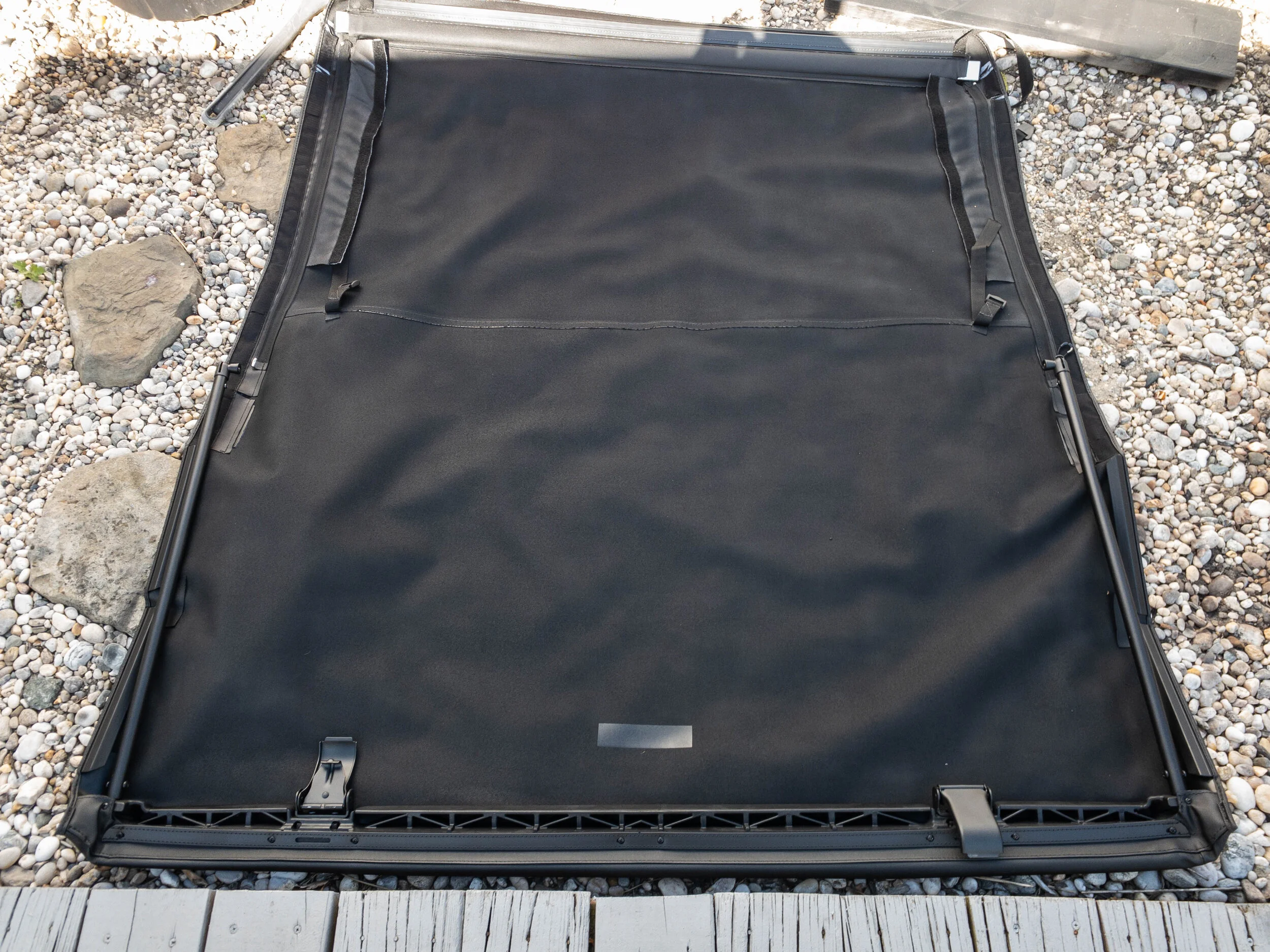

FWIW, like you I dislike the grey underside of the Bestop soft tops.. In my case a TrekTop NX.
I painted it years ago (and after the pics below, painted the back window fabric as well) using Duplicolor Fabric & Vinyl paint. It looks a million times better.

I just replaced the half door soft uppers and will be painting the inside to match.
Two or three years later and it looks just as good, though a little dusty. This is yesterday...
