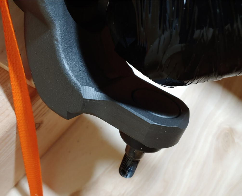

They aren't standard TJ ball joints either. They are bigger in diameter where they go into the C's.
I'm assuming they are JK ball joints. ECGS had a couple options when I ordered the axle.What do you buy if you need to replace them?
That's what ECGS said and they are the ones warranting the axle.JK ball joints are the same size as TJ, the only real difference is the lower has a different taper on the pin. I’d be shocked if whatever you got is really ready for 40’s.
Bullshit. The TJ knuckle won't work if you increase the area around the ball joints and it is already as thin as it can be. Even if you beef up the inner C with heavy duty forgings, you still have to carve most of it away or the stupid knuckle won't turn.They aren't standard TJ ball joints either. They are bigger in diameter where they go into the C's.
Maybe they aren't. I'm going off what I was told when I ordered the axles. No need to be a dick about it though.Bullshit. The TJ knuckle won't work if you increase the area around the ball joints and it is already as thin as it can be. Even if you beef up the inner C with heavy duty forgings, you still have to carve most of it away or the stupid knuckle won't turn.
Shouldn't be hard to prove me wrong, just post up a link to the hybrid ball joints that have a TJ knuckle pin diameter and a larger body. NBD.
They can say whatever they like, what they can't do is fix the problems that are created by running the TJ knuckles.That's what ECGS said and they are the ones warranting the axle.
It's the 489NR that I have.I’m not saying they didn’t say it but I’m sure they also want to sell axles and they probably aren’t going to be held up much liability wise if you break a ball joint on 40’s.
Unless I’m missing something, the only thing remotely close to a Dana 44 for the front of a TJ they sell is the 489NR and it uses OE YJ/XJ/TJ Dana Spicer ball joints or has an option for Synergy or no ball joints. I know first hand what a pile of garbage Synergy ball joints are, those wore out on me in a year on 31’s on the street.
