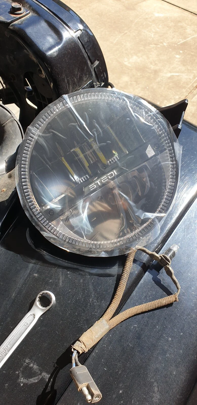

By and large the electrical systems are pretty common across both RHD and LHD. The biggest challenges we tend to face with US imported parts are things like the AC/HVAC and some of the piping and cabling associated with brakes etc. I would make sure you thoroughly do your research before adding LED globes into your system though.
For headlights, the overwhelming majority of 7" LED headlight replacements sold are NOT ADR compliant and will produce a pattern that is completely wrong for RHD vehicles. You will wind up blinding oncoming drivers and risk a defective vehicle notice. One of the few that is compliant is https://autoelecoz.com.au/product/stedi-7-inch-iris-led-headlight/ - don't skimp on the headlights - buy once cry once. Those $99 eBay specials are not worth it esp in a RHD Jeep.

Cheers Bammo68 for your detailed response, very helpful. I have a pair of STEDI's lined up, so should be all good for the headlights, definitely wasn't going to skimp there. Indicators and other exterior lights I may do a little later down the line after some more research. I would probably replace the entire exterior light assemblies with compliant units, rather than straight globe swaps.

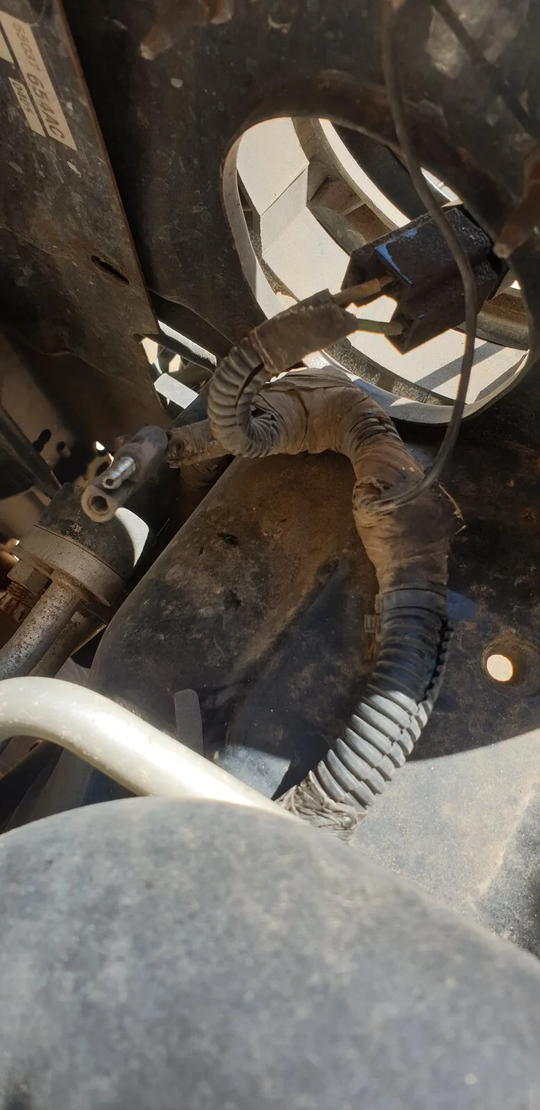

Hi bammo68, wondering if your homage lights were plug.n.play or if you had to deal with the separate circuit for ths parking light? Mine is an 05 and the parking lamp seems to be split from the low and high beam circuit. Wondered if you had encountered this and what you did?
