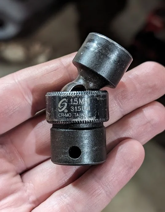

Reviving this old thread to add info, since a search didn't bring anything up for me. The OEM exhaust manifold to pre-cat flange bolts on my 2005 are M10-1.5x45. 15mm socket.
I'll revive this old thread again, again, as I'm dropping my exhaust to do the rear main seal for a third time.
I've tried multiple different types/styles of swivels and These Sunex swivel sockets make getting to those bolts a much easier task. Even allow enough movement for me to get a Milwaukee impact up in there. They swivel very close to the head of the bolt. Pretty handy other places too.
