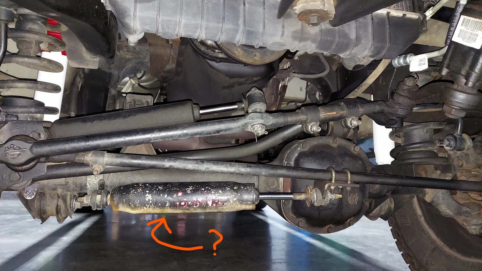

Slowly replacing suspension parts on a recently acquired 05 LJ. Picked up a Monroe steering stabilizer to replace the factory one and now I'm noticing that the PO has installed a second steering stabilizer between the axle and tie rod. Appears to be some sort of Rough Country product that was spray painted black. Anyway, I can't find any record of this being done by anyone on this forum (or anywhere at all actually). So is this thing functional or beneficial at all or should I just trash it, install the Monroe replacement at the factory position and be done with it? Thanks
I have both on mine. The extra one added to the tie rod end adjusting sleeve took my steering from quite lite, to somewhat heavy. I prefer a heavier steering, so it was a good move for me.

The previous owner was clueless and incorrectly assumed if one is good two must be better. Run just the new Monroe you bought and remove the second damper on the bottom. The second damper just forces the power steering pump to have to work harder than it was does for. In hot conditions that could be the difference between the power steering system overheating or not.
A second stabilizer isn't typically put on for kicks...it's usually a misguided attempt to solve death wobble.
A properly set up suspension with the correct geometry shouldn't need one stabilizer, however there is benefit to having one

It does, isolating the steering system from the jolts and impacts encountered while driving. More correctly called a steering damper.
Misguided is a good description, clueless is another. For those who erroneously think a new or stronger damper is the cure for DW.

There has been this 2 stabilizer setup since the day after a 1 stabilizer setup was made. And the companies love to push poor info onto folks that don't work on vehicles all the time. It was a big fad in the 80's to have all sorts of dumb 💩 bolted on to your truck or Jeep. In general, if the machine didn't need it when new then it shouldn't need it now. Just go through and do a good dry steering test to make sure everything else in the steering is tight and secure.

I had to replace leaking power steering hoses right after I bought it. Possibly related to this unnecessary damper? Anyway, I will remove it and see how it goes. Thanks
