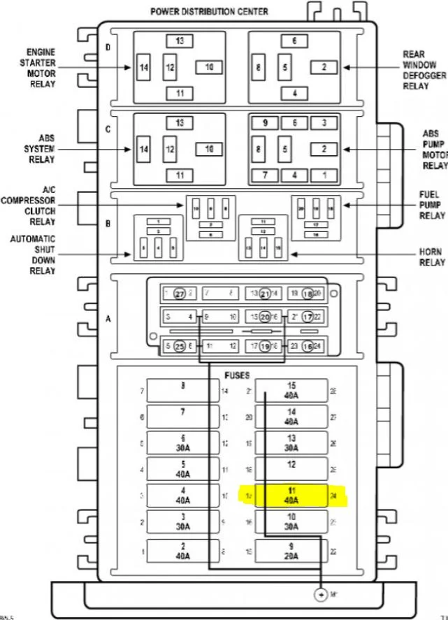

That's usually caused by the 40 amp IOD fuse #17 located inside the PDC (Power Distribution Center) that sits in front of the battery on the passenger-side fender well.

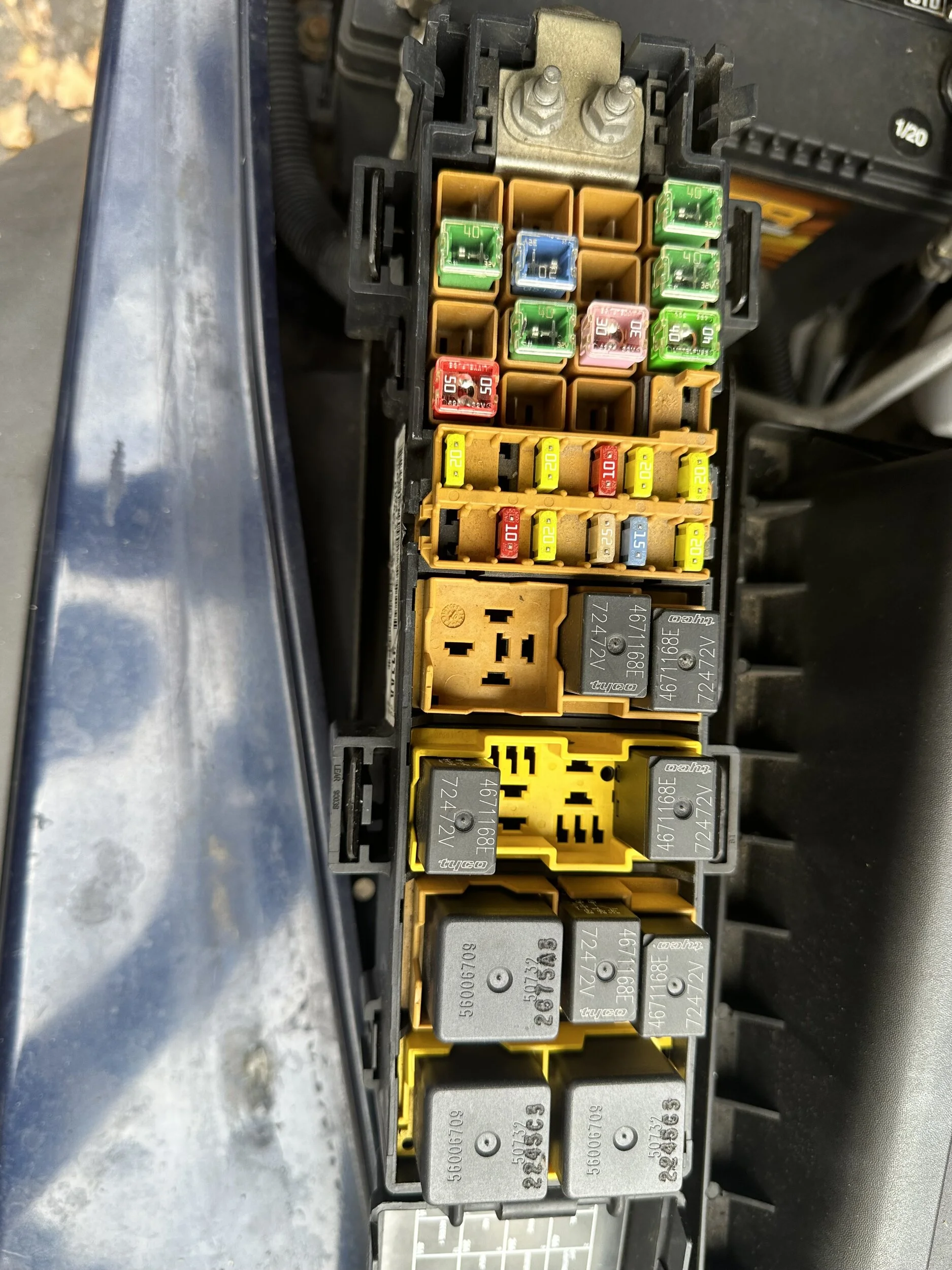

Jerry mine looks a little different. It is a 50 amp. I changed it and the no fuse is still flashing. Any other ideas?
This may be unrelated but I have had instances where the radio stays on after I cut the jeep off. All I know is that the dome lights are not working right now.
I wish I knew what it controlled as well. I was just trouble shooting fuses and that fixed it. Saw that it was labeled, offroad.
I thought it was for the lockers, but after Googling it I also saw clutch override mentioned.
Based on 2006 FSM, it's for the lockers.
