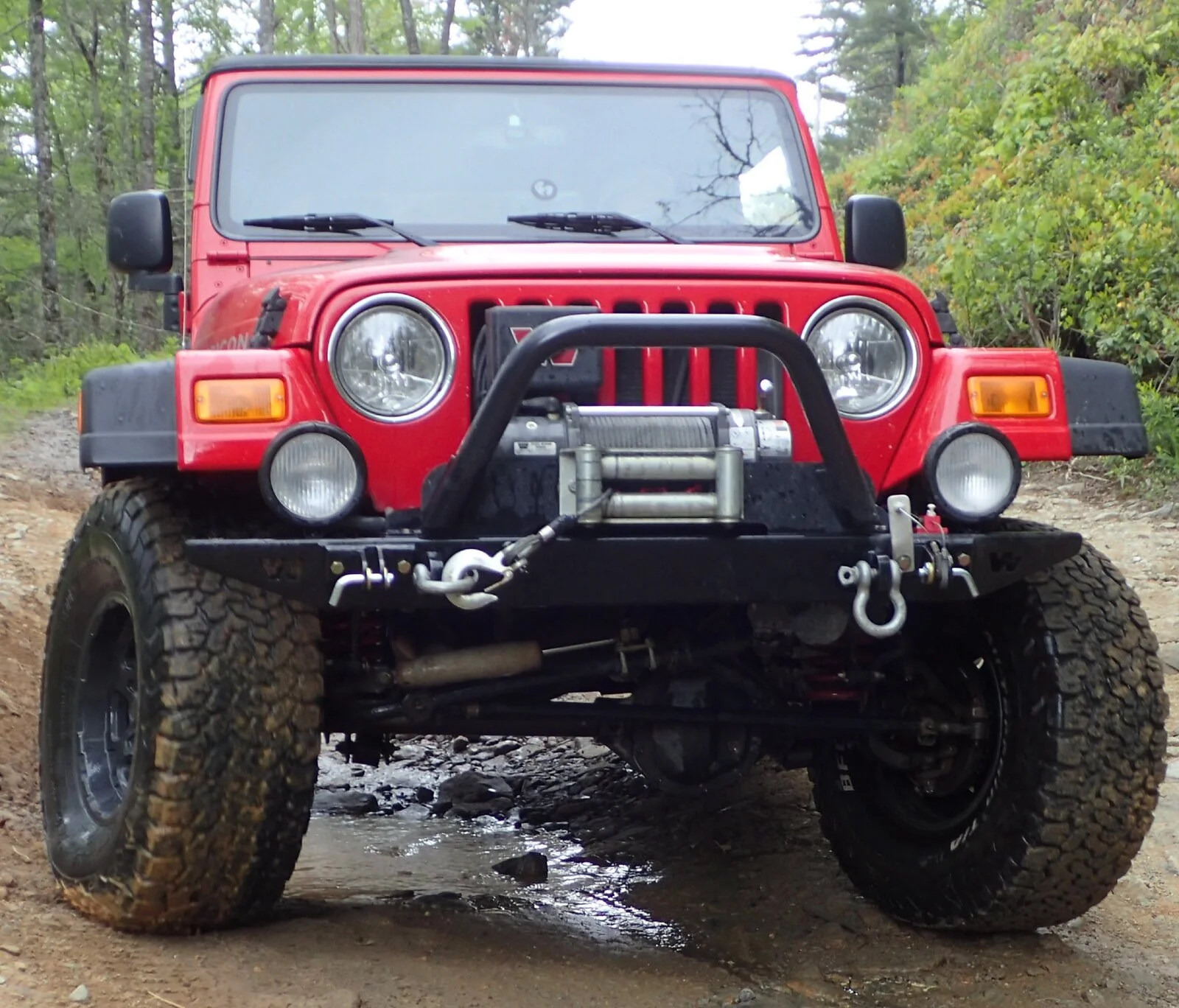

I never saw how the stock bumper was attached, this one has about six high strength bolts and I’ve read other Postings where people said they towed with no problem but thinking of welding it to the TJ frame— wondered if anybody has gone down this road?
It's more than strong enough. Six high strength Grade 5 1/2x13 bolts pass through it directly it to the frame below.

I have flat towed my YJ many many times with that same Warn bumper w/o any issues what-so-ever

I have the exact bumpers front and rear. I tow a 5x11 trailer regularly. I towed it 2,000 miles to and from Moab with nearly a gross weight of 1,700lbs.
That rear bumper is not just bolted to the frame, it also has 8 more bolts up behind the gas tank that bolt to the crossmember. The receiver is through-welded. To strengthen it further, get some frame tie-ins.
At that point, it’s virtually indestructible.
As long as the Warn bumper is properly bolted to the frame it will be strong enough to flat tow your jeep.

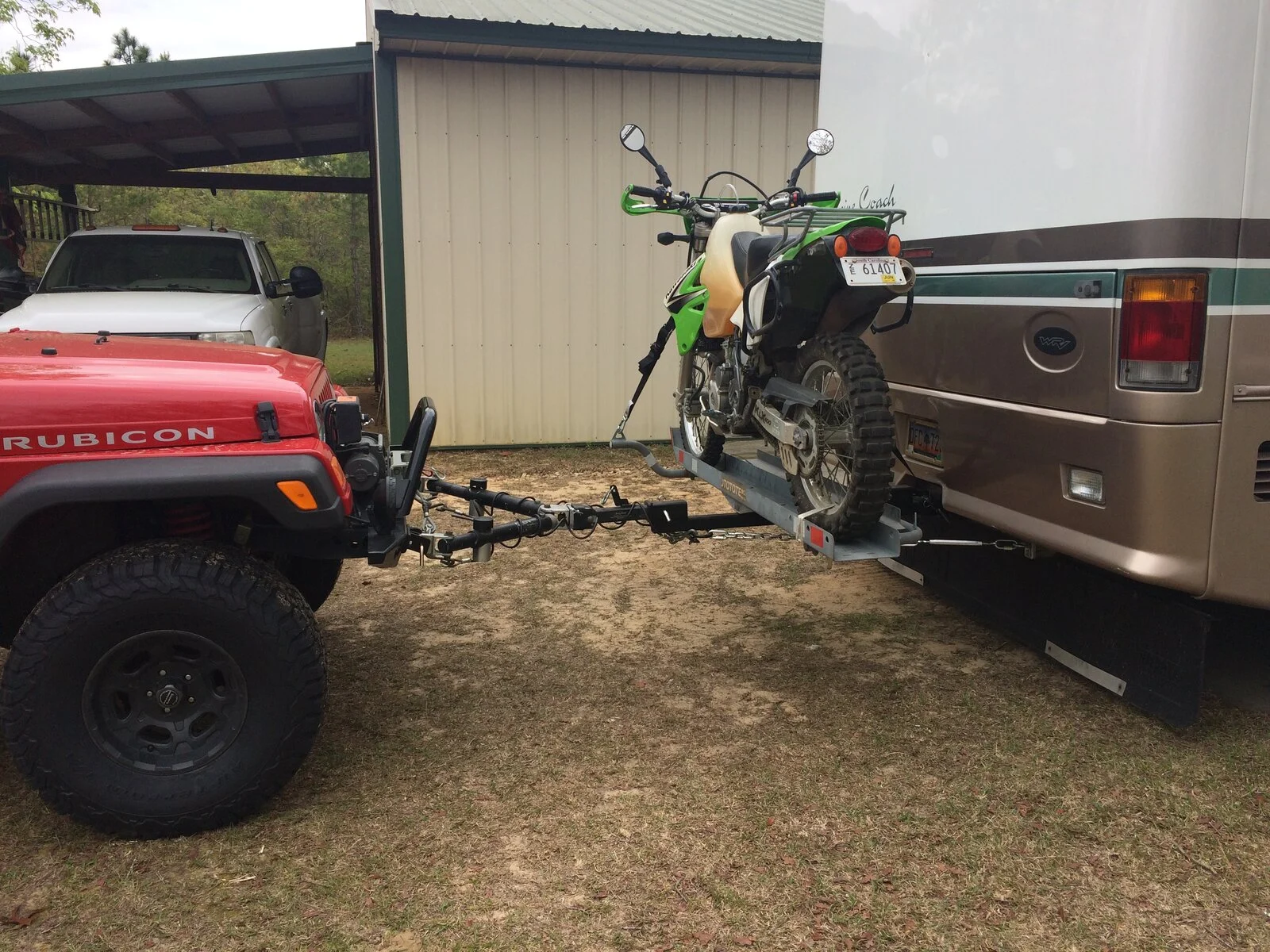

I have a Warn stubby front bumper the the PO installed on my Jeep with the complete set-up for flat towing, I’ve never used it but as Jerry said it looks like it’s more than strong enough. I can post pictures if you want to see how this one is attached.

I had brackets made that bolt on to the bumper my tow bar connect too. I used a 1/4" bottom plate with 2 pieces of angle iron welded to the plate. One side of the plate bolts through the bumper to the frame. I leave my shackles in place and connected to my safety cables there. I use a Ready Brute Elite tow bar with a surge brake (blue box connectors) and wireless battery operated lights.
