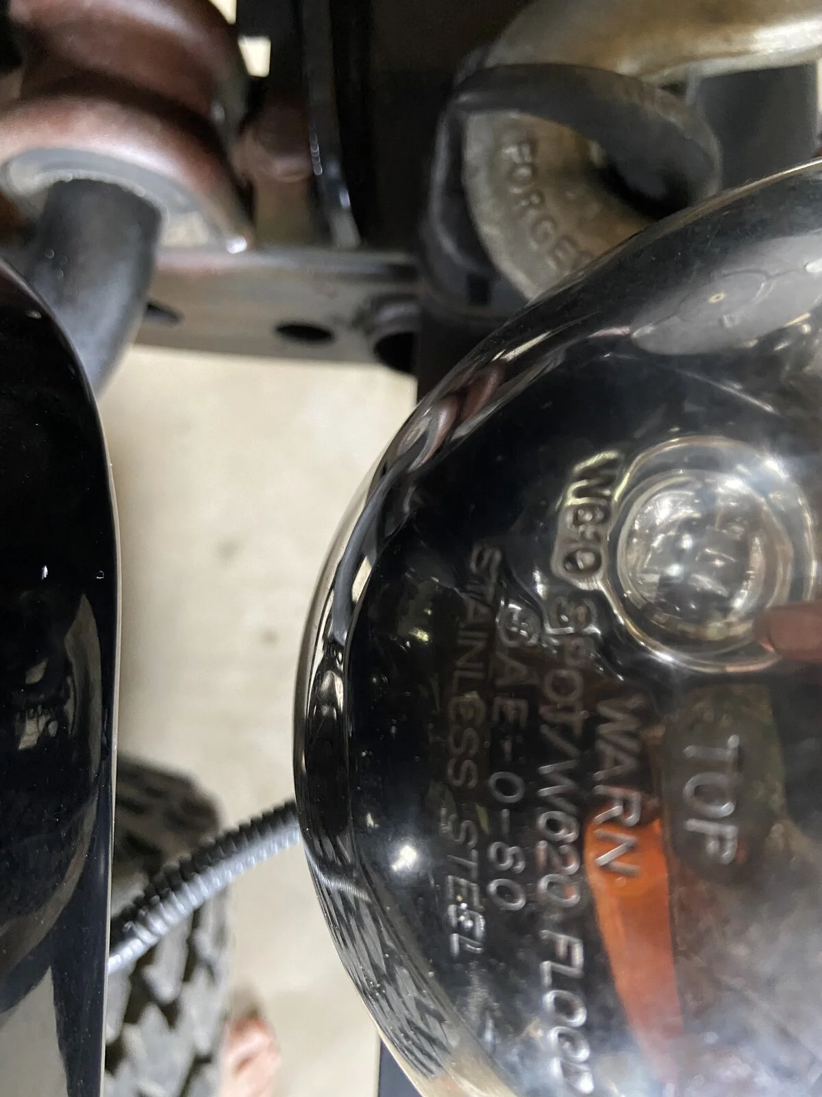

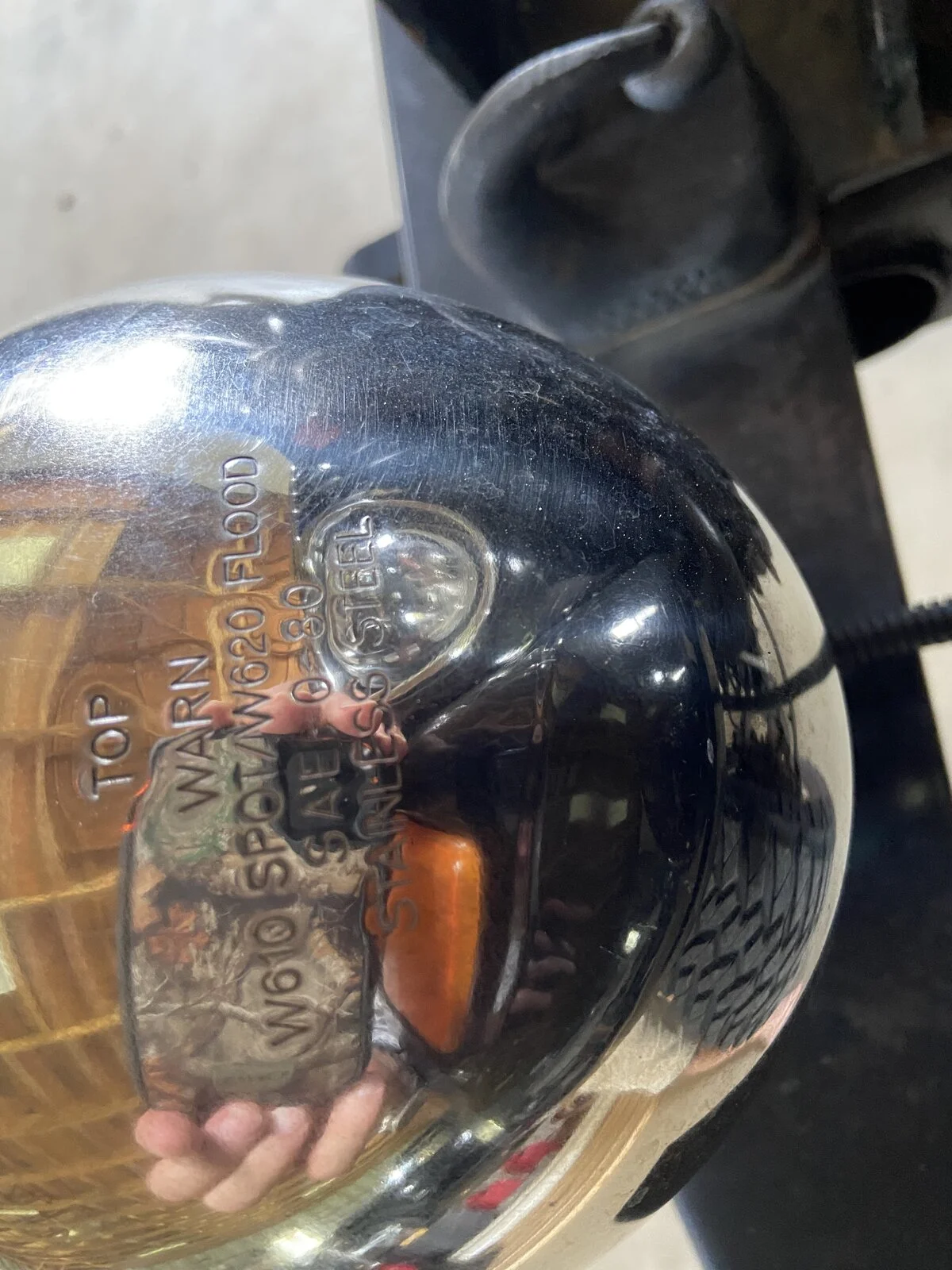

It has warn chrome W610 fog lights, not sure if they are factory installed but appear to be part of OEM wiring

Are they OEM?
Appreciate ideas
Do you have a picture?
You mean picture of fog light?
