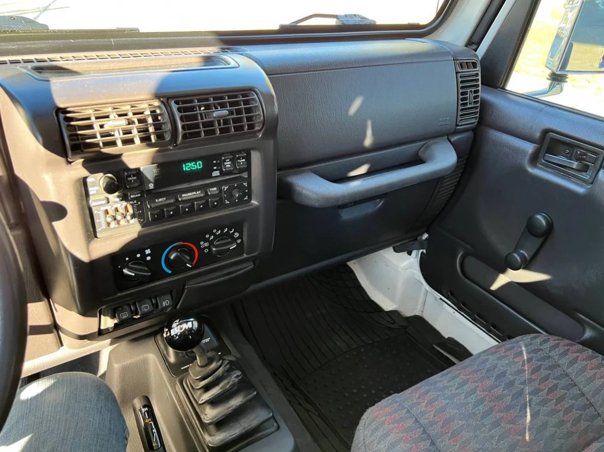

My 2000 has a switch on the dash and the owner's manual confirms that it is for fog lights, but I don't have fog lights. The indicator on the switch does not light up, and I don't see any abandoned wiring under the fenders. If I have the switch does that mean there once was fog lights? I researched a little and found that there is a relay that cuts off the high beams when the fog lights are switched on, but I'm not sure if there is another relay to handle the current of the fog lights or if I even need one if using low current LEDs. Not sure where to start other than pulling the switch first to see if wires are attached then go from there. Any tips or links appreciated.
I have a 2000 Sahara with fog lights and that same switch. the build sheet tells me it came from the factory that way. can't help with the wiring questions.
