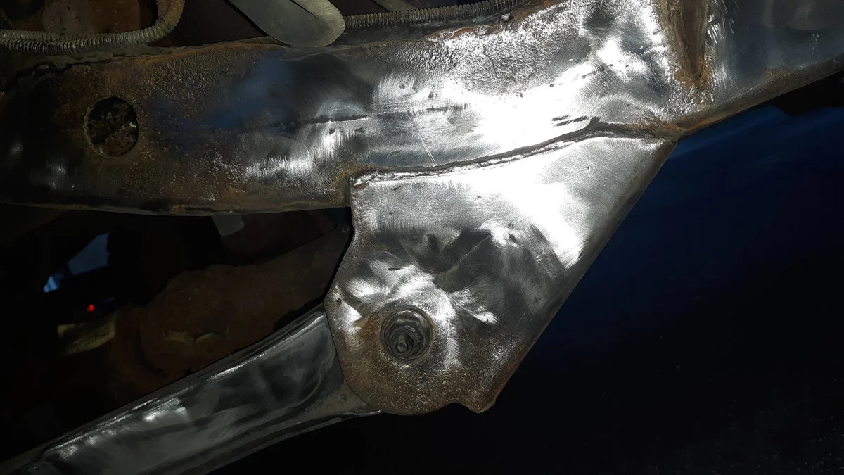

What is the story on that weld along the top edge of the transfer case skid pan? Surely the skid plate isn’t welded to the frame is it? Maybe this was a previous repair to the bottom of the frame where it had rusted out?
PO told me he had to weld a piece of metal on both sides because either the bolts snapped or he cut them off dont remember. ..

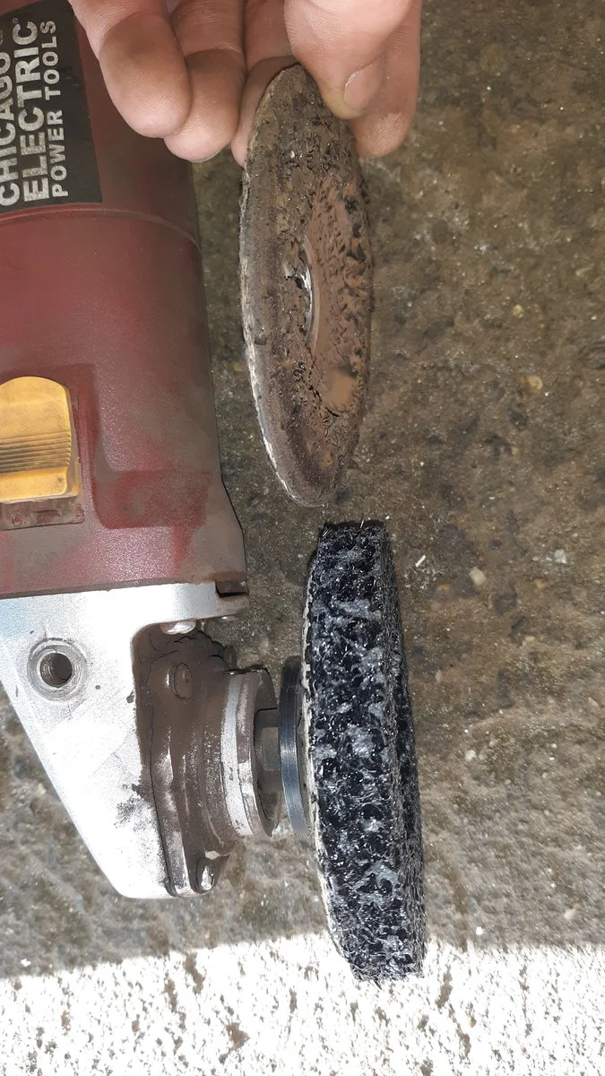

That's lookin' sweet and clean! I got the exact same tools at local tractor supply this morning...
You gonna need more then one, I stoped by today i got few more while they still have them.
Yeah thing works great.

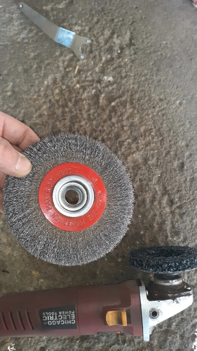

@robert_tj_ski how is the progress on your frame? I am about to tackle the same job. Going to be stripping the frame with a similar scrub pad, and prepping for the POR15. I also ordered the internal frame paint. I know some are weary of encapsulating rust, but we don't have much choice up here in MA. My TJ is also a 2nd vehicle so I have plenty of time to clean the frame up right and do the 3 step POR15 process. What did you decide on for the tub? I've used a paint on undercoating in the past that I had success with. I can't remember what its called but it dries hard, not like the rubberized undercoating so its easier to clean.

It had POR15 applied by PO and originally I was going to reapply POR15 too but after what i discovered what's happening underneath that i dicided NOT to apply again. I talked to few ppl (including honest guy how applies undercoating for living) they all saying POR15 is not that great you'll never have good results unless you take everything apart and do piece by piece. So I decided to clean everything as good as I can, then treat everything with "klean at stripper prep and etch" from home depot it's an chemical for rust it's the same chemical as the small bottle for big $. Then apply rustoleum rust reformer and pot coat it with some spray paint. It would be easy to observe new rust and treat it right away. For inside I have the Eastwood product.

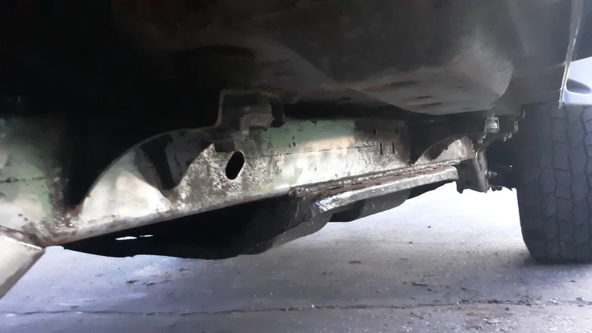

I have couple weak spots you can see them on the pictures. Still dont know what to do with them, it's not bad as it looks on the pictures. Might do some patch idk yet.

@robert_tj_ski looking good. Those holes could be patched, I unfortunately don't know any good welders. I live in the Salem/Lynn area. So you decided against the POR15? is Chassis Saver in a similar realm? I like the idea of coating everything just once and done. I used the rustoleum rust reformer on my 2013 Silverado last year and it's already breaking down.
Yes I'm against the POR15 unfortunately. How did you prepped? You have to degrease everything. I feel like prep is the key... also did you just left it like that or top coat it with paint ? I've read you need to top coat it within so many hours for best results.
I dont know what to do with these two spots. Someone said he could put an "L" profile over it and bent it to the frame shape. Other guy said he could grind out the weak spots and put a patch of the hole shape (but said he wouldn't have time now and recommended me to just keep going I still have like 80% left on these areas he said.... Idk what to do and what would be the best.
