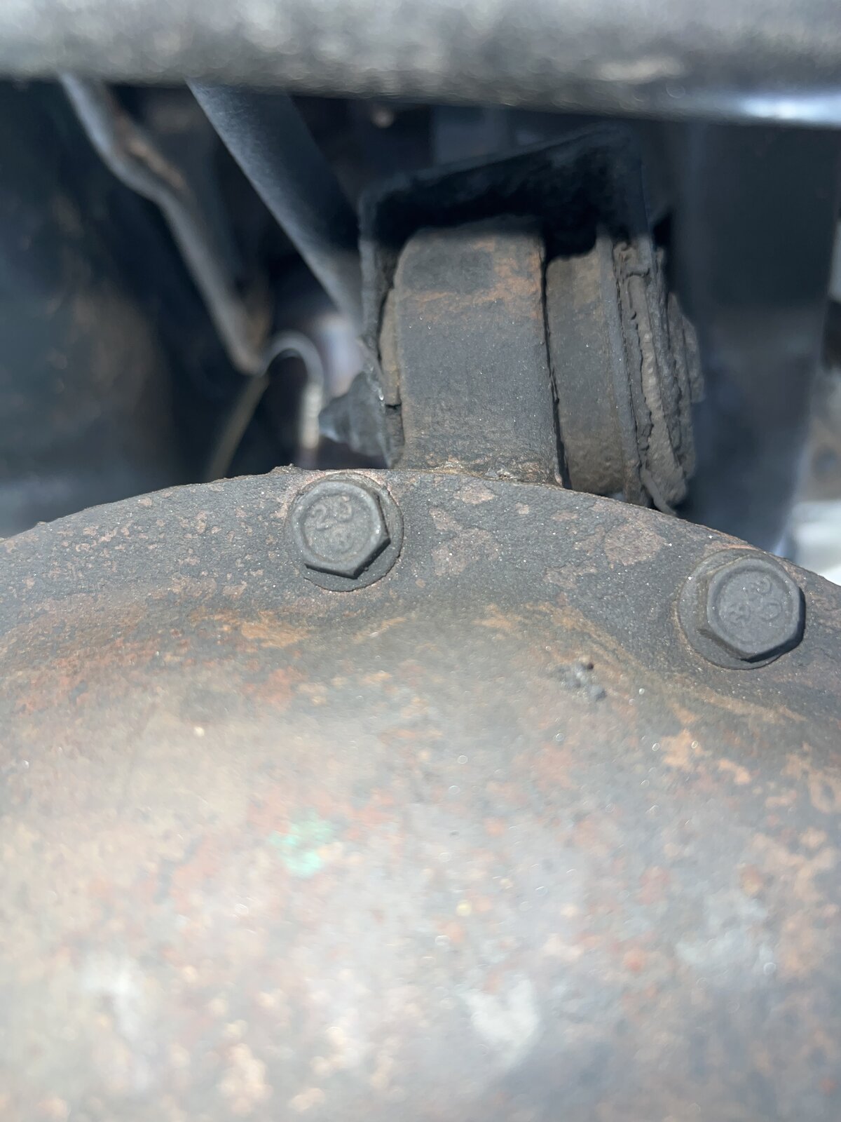

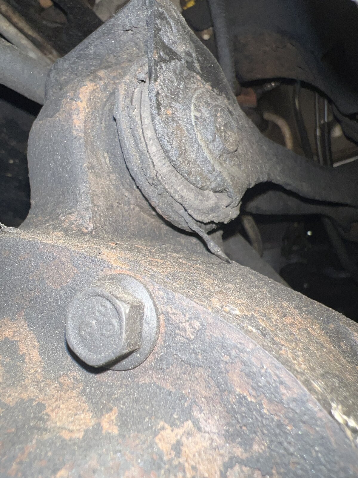

Pop is audible at the end of video. Been chasing this pop for what seems like forever now. When I turn hard right my front end makes a LOUD popping noise like something is binding. Happens when I turn left sometimes as well but only when moving and less severe. I have replaced 6 of 8 control arms, axle U-Joints, and one tie rod end. It sounds like it is coming from the passenger side. The coil is not rubbing against the bucket either. Any ideas? Could a bad unit bearing cause this?
Could it be my driver side axle control arm bushing maybe? Looks pretty beat to me.
