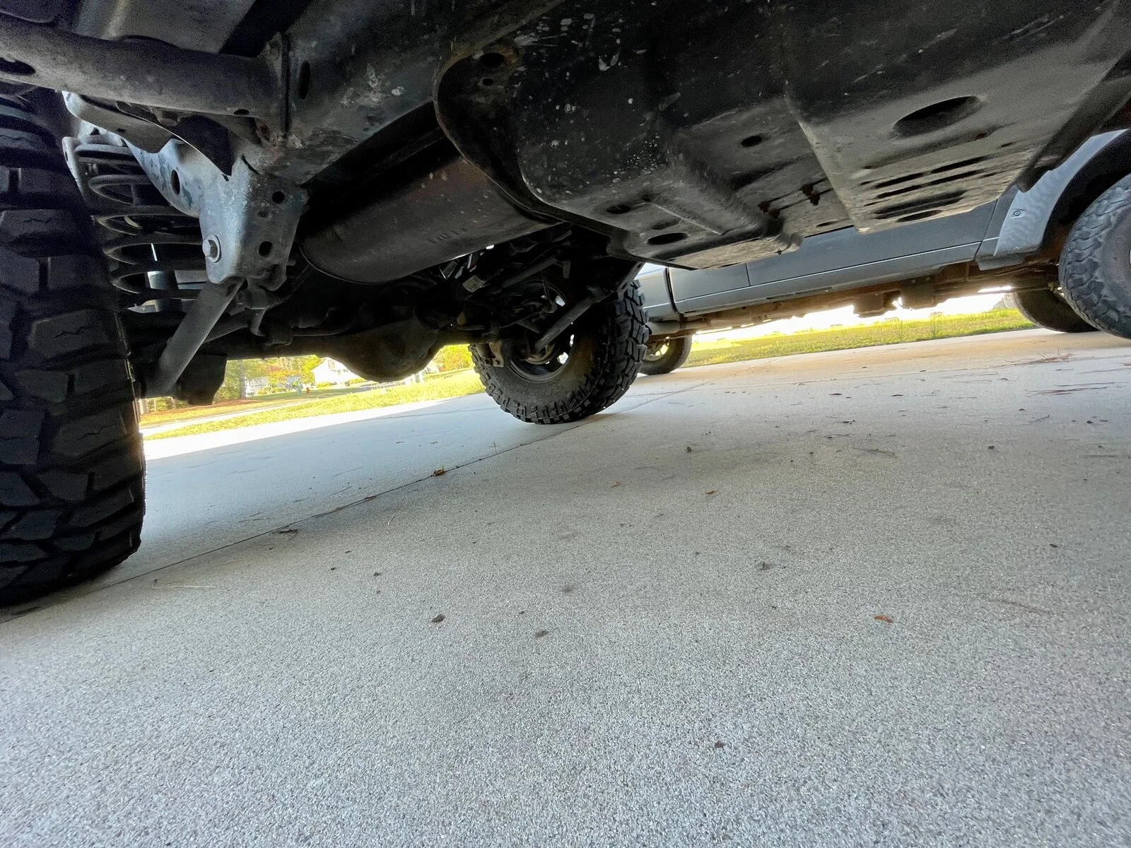

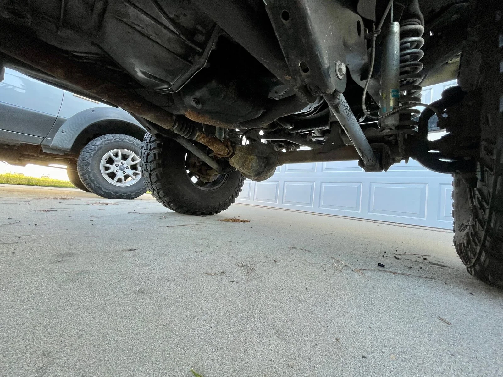

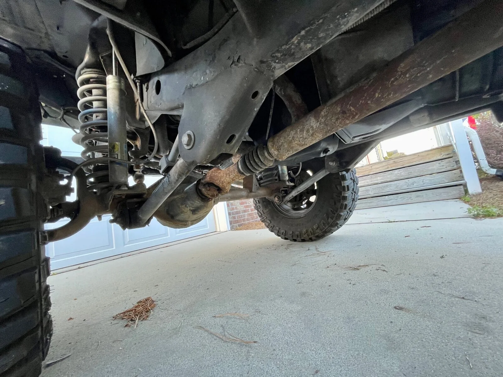

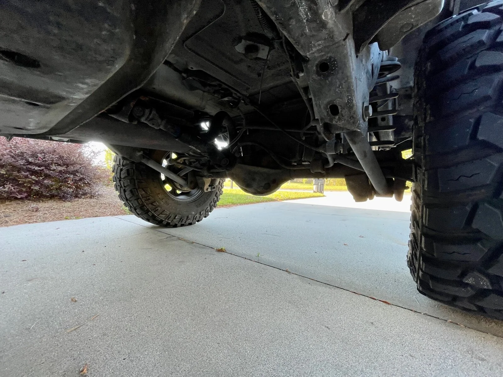

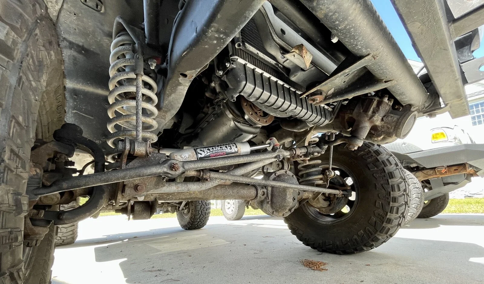

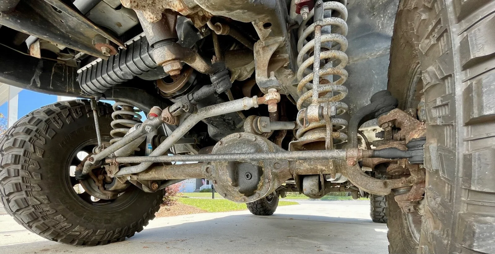

Now onto the fun part, I was looking into doing the ZJ Tie Rod upgrade and noticed that someone had installed a dropped pitman arm and the track bar appears to be aftermarket on my TJ and still has the original TJ tie rod. I am wanting to rebuild the front end and any other suspension components that looks suspect. I don't have death wobble but sometimes when I'm in 1st and 2nd gear and hit a bump it tends to wander but then chills out. I've never done a pitman arm myself and neither has my YJ enthusiast friend. I believe the 4" lift is Rough Country based upon the color of the shocks (can someone on here confirm this for me?) Please take a look at the pics and let me know your thoughts on what parts I have that I haven't identified and if I should do the whole ZJ Tie Rod upgrade or if some parts are still okay ie the aftermarket track bar.

Shocks are Bilstein not rough country. Could be an old rubicon express lift but not sure. Removal of the pitman arm is easy if you rent the tool from an auto parts store.

Its not clear to me that the pitman arm isn't stock. Better pics of arm from side and of whole front end from the front might help. Dry steering test and close inspection of all tie rod, drag link, control arm, and track bar ends would be good. Don't forget to check for play in ball joints. Finally, in addition to evenly worn tires at the right pressure, proper toe and caster are important.

Thank for your help Jerry. As you mentioned, the Track Bar looking to be Rubicon Express it appears I might have the Rubicon Express 4.5" Super-Flex Short Arm Lift Kit - RE7000
I would go with RE as well. I would measure the springs as RE is known for being taller than advertised so it could be a 3.5 inch as well.

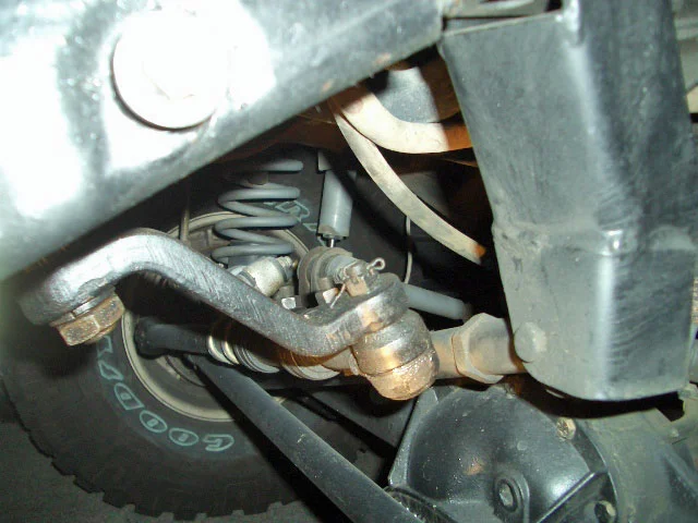

Here’s another picture from the side

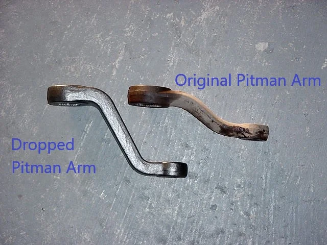

Was that supposed to be a good side-shot photo of the Pitman arm? ;) This is a good photo of a dropped Pitman arm. Note that not all dropped Pitman arms have as much drop as this one does. Yours certainly looks dropped though I could see it more easily in an earlier photo. :)
Ok good photo and that is good news, your Pitman arm is not dropped so it can stay.
