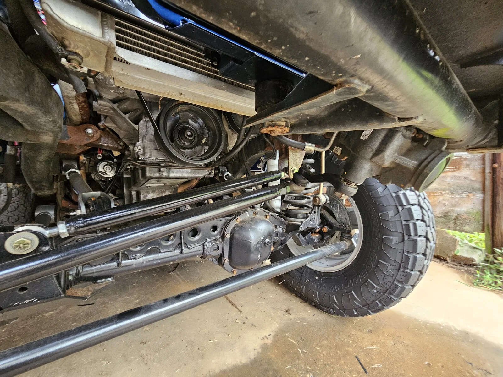

While I was redoing some other things on my jeep I decided to replace my front axle with a dana 30HP. Very long story short, I didn't stop there and ended up converting to crossover over steering (a regret), relocated my track bar (another regret), and upgraded my brakes using WJ rotors and calipers (yet another regret). I have yet to drive it on the road any length of time so I'm not quite sure how it drives at speed over bumps. I figured I would post some pics on here so folks could give me some opinions on it and either make me fully commit to tearing it out and starting fresh or live with it.
Dana 30 HP
Artec truss kit
Johnny joints at both ends of track bar.
1 1/4" dia. 1/4" wall DOM tubing for tie rod, drag link and track bar
1 ton GM tie rod ends
What I wish I would have done was bought a Currie Dana 44, Currie steering and Vanco big brake conversion. Jeep lives primarily on the road so off road performance is not a must for me. I mostly did it for a project and am now not sure I am happy with the results. I'm hoping to get the last few things buttoned up on the Jeep this weekend so I can start driving it again. Let me know what you think.

Im no Jeep expert, but your gonna have some bump steer quirks. That track bar is super short compared to the drag link.

As far as crossover steering on a TJ goes, you could have done a LOT worse. The FB groups are littered with $150 steinjager setups with stock track bars and "no issues".
I say drive it and see what you think before you go back and rip it all out. It might not bother you.
