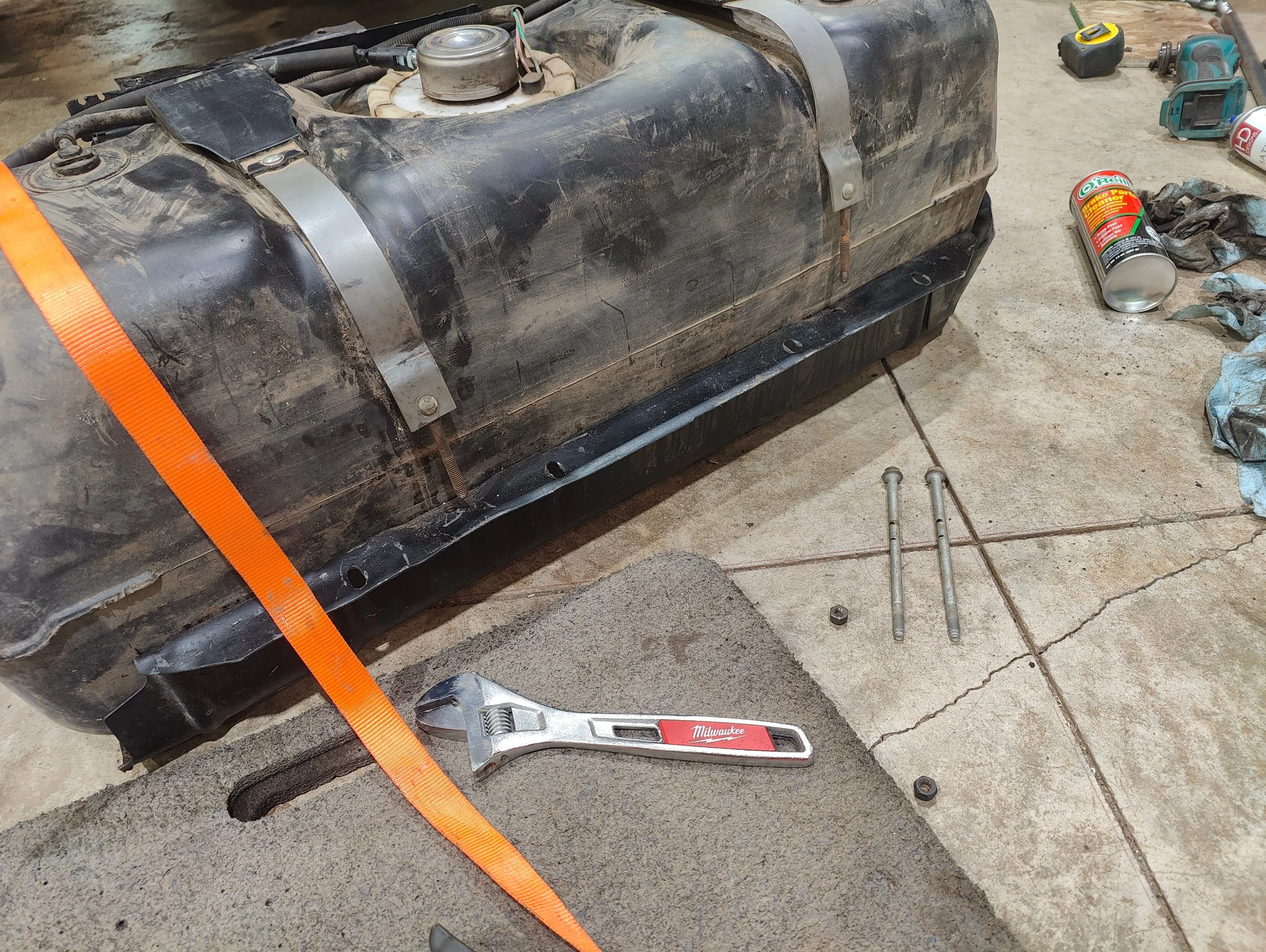

I started to diagnose why my Jeep is so hard to start today. I've always suspected the anti drain back valve, but before I drop nearly 200 bucks on a new assembly, I wanted to be sure.
Oh... Curse Jeep for removing the Schrader valve from the fuel rail. Cost me an extra 30 bucks to build an adapter to get my pressure gauge installed!
Pretty sure this is the confirmation I was looking for...
Going to order the Bosch replacement from Amazon. Good thing I've got so much practice dropping the tank!
