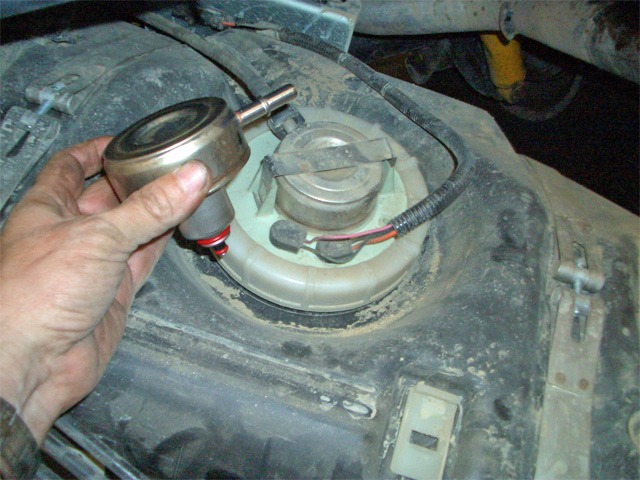

Jerry...I did a fuel pressure test on my 2.5 today. Read zero with the key turned on. Several times cycling the key did not do anything. Starting the engine and it took several tries...more than normal but that was due to my having to disconnect the fuel rail and put an adapter on since I don't have a Schrader. Usually between 1-4 tries to start. Anyway, it starts to build pressure when the starter is engaged. She starts, but never gets above 25 psi. Also when the vehicle is shut off, pressure almost immediately drops back to zero. Does that sound like a check valve in the regulator, or the fuel pump, or and electrical issue?
With the fuel pressure dropping off nearly immediately I'd guess it's the check valve inside the fuel pressure regulator which sits outside the gas tank on top of the fuel pump assembly.
This thing I'm holding that will replace the old one still installed below it.
Yeah...I'm aware of it's location. I figured that as well. The fact that it won't get above 25 psi is what makes me hesitate though. Of course, if one thing is wrong in the regulator, more could be clabbered. I'm surprised that it runs decently with only 25 psi. Having a little trouble locating just the regulator. Seems that most places are listing the little secondary one on the fuel rail.
