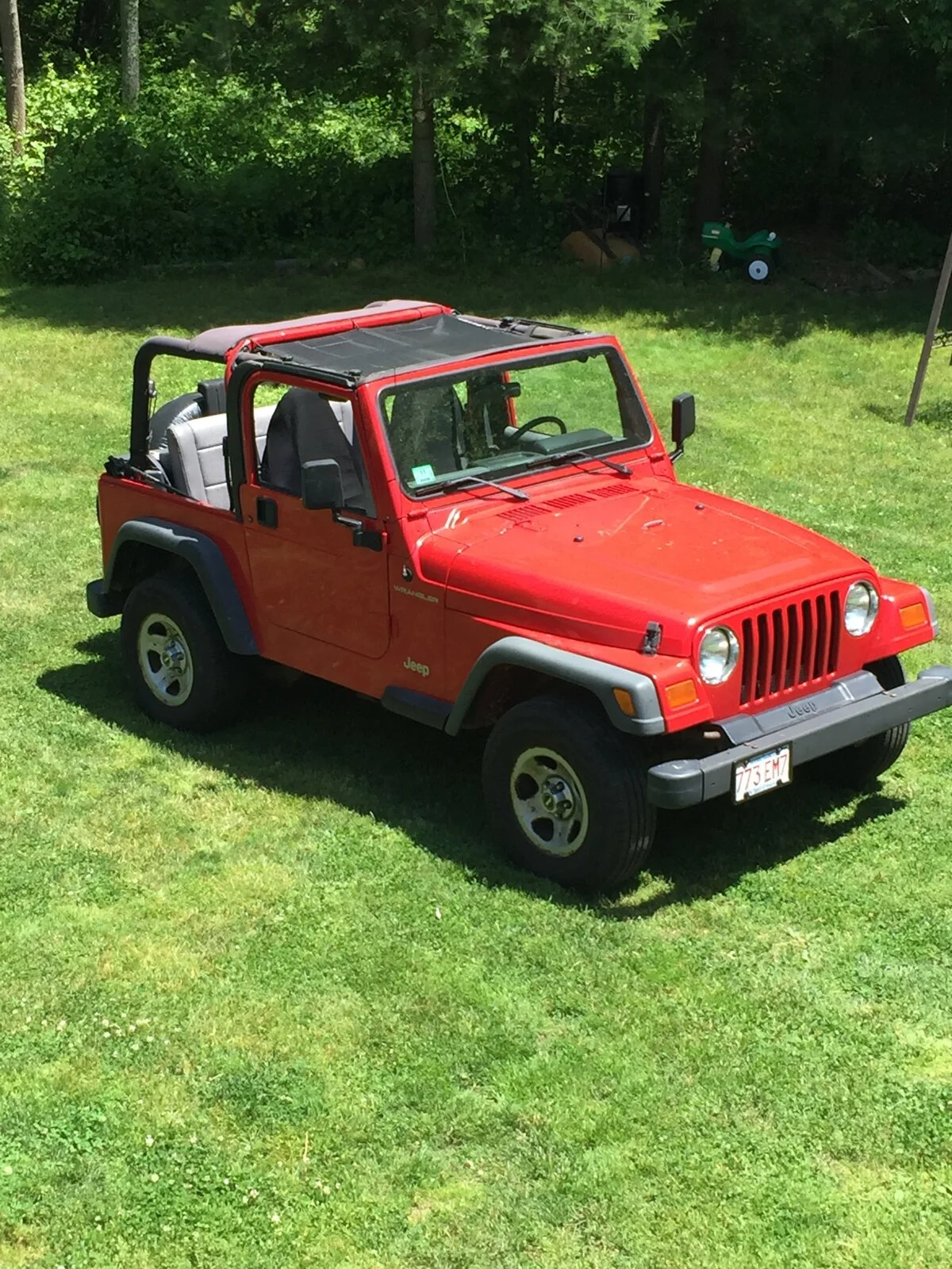

I'm picking up a hard top soon for my '97. The top comes from a 2005. Will I need to remove the rubber seal, I think it's called a windshield channel, to secure the hard top? I won't be using the soft top anymore. You can see it on this pic. It's lifting slightly in the center. Thanks.
windshield channel stays in place for the hardtop. no difference that I am aware of between hard or soft top usage. hardtop will have two clamps to lock the front down similar to the soft top windshield headers clamps. that windshield channel is the gasket seal for the hardtop.

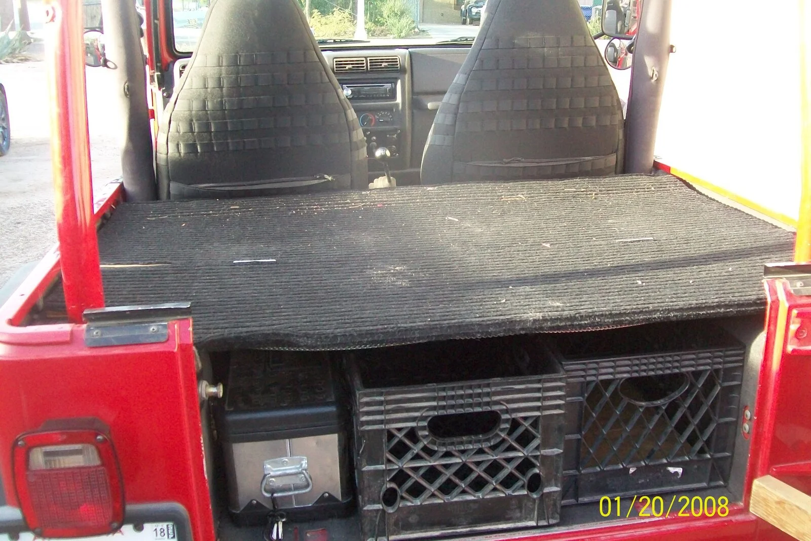

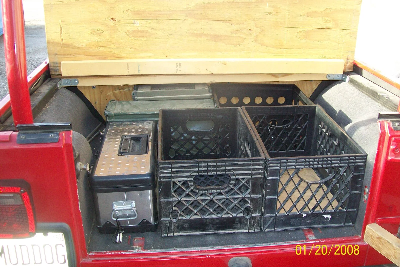

Removed the back seat and console the minute I got it home from seller a couple years ago. The area is suitable including a medium fridge. Old men like me don't need any stinking back seats! It's just the access.....getting to the stuff. If one needs a back seat, Wrangler solved that 14 years ago. Been out days on trails. Nothing wrong with cargo area sans seat.
Pretty much what I did.
That’s the least of your worries. The 03-06 hardtop does not have vents. They put vents in the tailgate those years. The 97-02 tops had vents. You need vents. You won’t have them on your tailgate. Short story; an 03-06 can use a 97-02 top, but not vice versa
