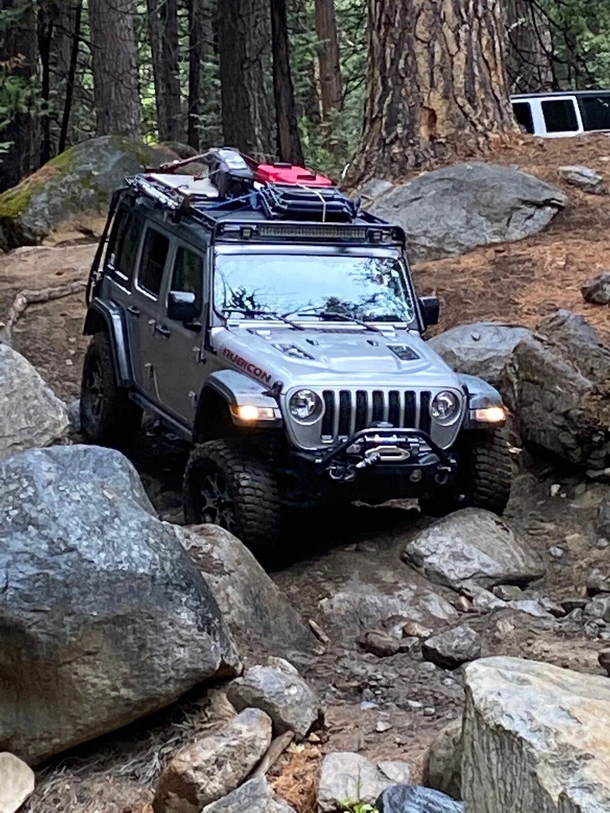

So I know this is a TJ Forum BUT just did a trip this weekend with @Alex01 and the @Gone-N-Done-It and two JL's. One of the JL's in a buddy of mine that is running a Gobi Roof Rack/

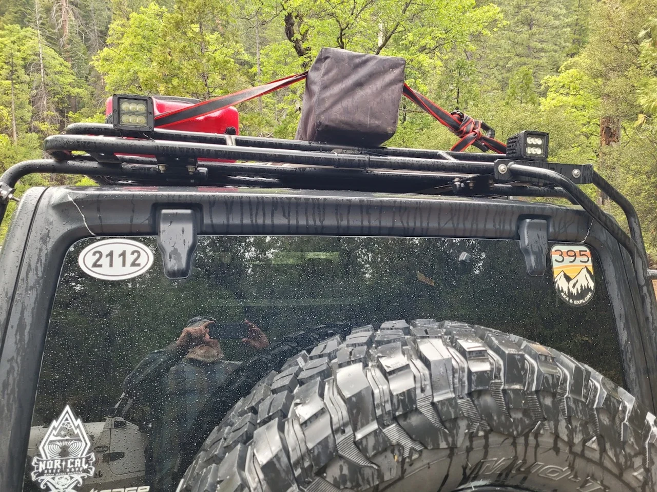

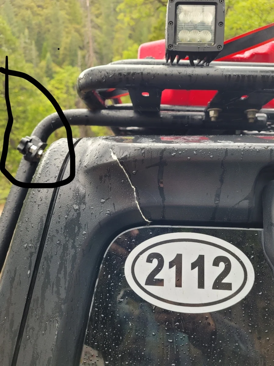

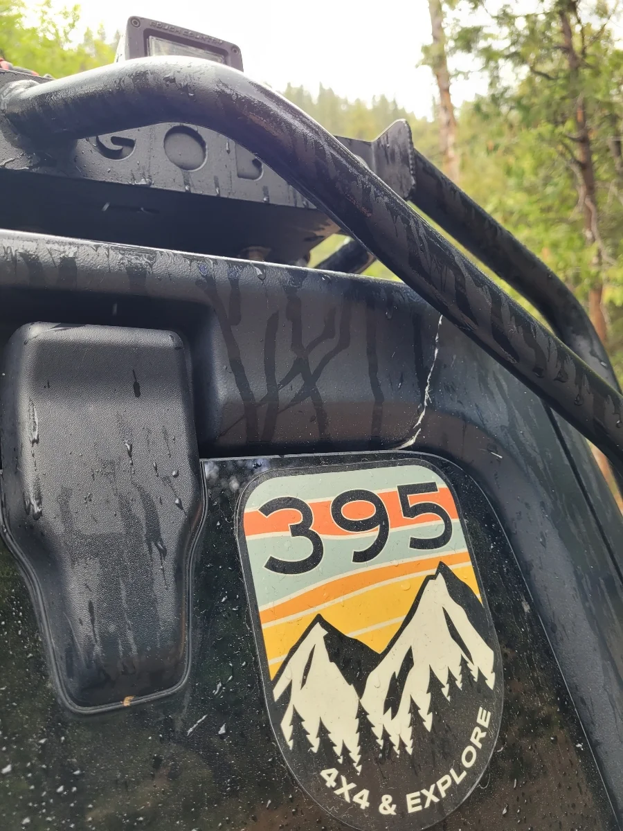

You can see that his hard top cracked in two places. The only thing we can think of that the Gobi Rack has bolts with rubber pads that tighten against the top. And that during some flexing on the trail it caused the fiberglass hard top to crack. He did not hit anything like a tree that caused this to happen, so this is our only explanation. Has anyone else ever seen this before? if so let me know
