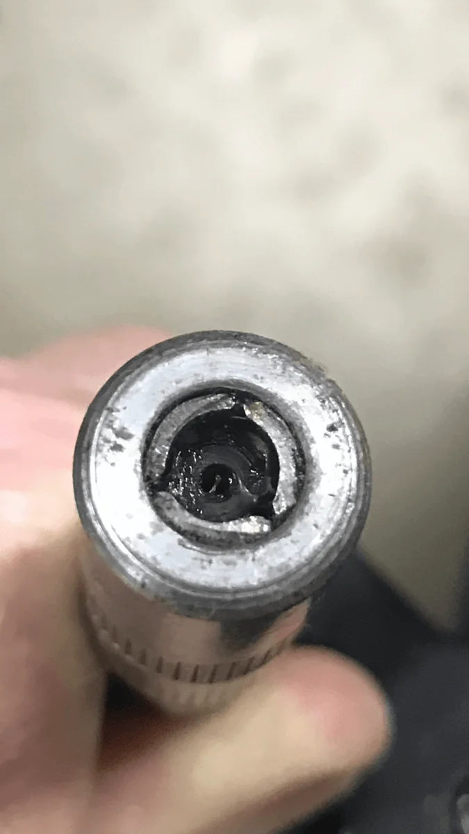

Funny. Turned around and there it was hanging right behind me. Yeah looks like it works as I thought. So if yours looks like this your gun is good.
It is a ball check that is designed to open under pressure from the grease gun. I would try a replacement hose with a new connector.
Yeah it is an old mini grease gun and probably no good any more, I have been wanting to get a new bigger one with a flex hose anyway.
